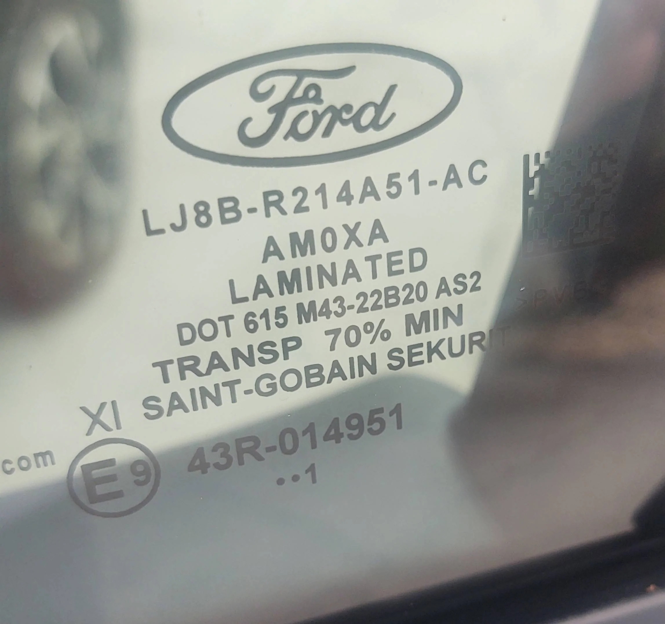

The 2021 windows were laminated for additional sound proofing. At some point (2022?) Ford changed to cheaper standard glass as it didn't make much difference in noise. If you had laminated, you should stay with it. The window will have this on it:

You should take the picture like above and tell Safelite to match it.
