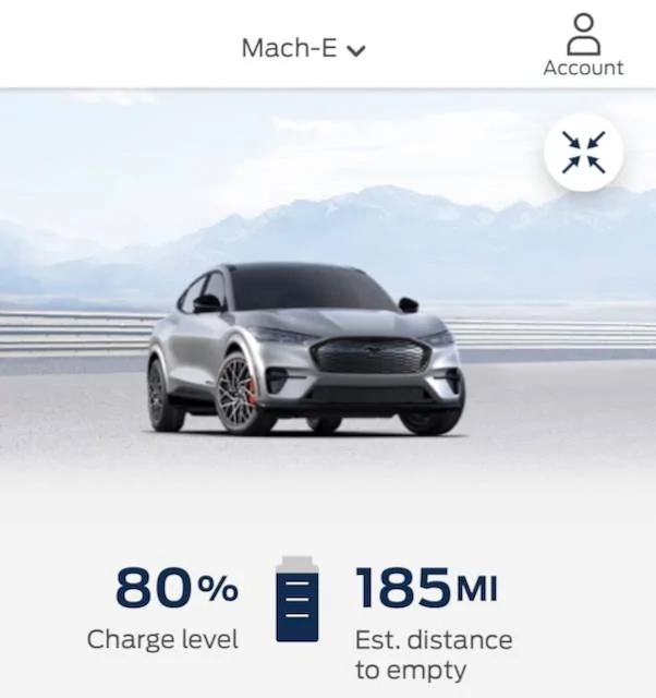

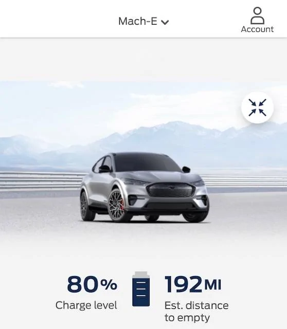

Not sure if this is relevant to you but thought I would share.
One time last year in the winter, I left my car outside overnight with an 80% SOC. While the SOC did not change, (would not expect it to) the GOM sure did.
At 7:00 PM
Ford Mustang Mach-E New 2024 draining overnight. Normal? IMG_8336
Next morning at 5:00 AM:
Ford Mustang Mach-E New 2024 draining overnight. Normal? IMG_8337
And at 9:00 am:
Ford Mustang Mach-E New 2024 draining overnight. Normal? IMG_8338
