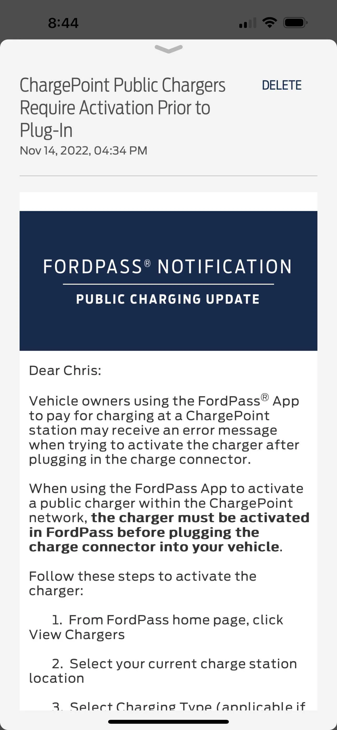

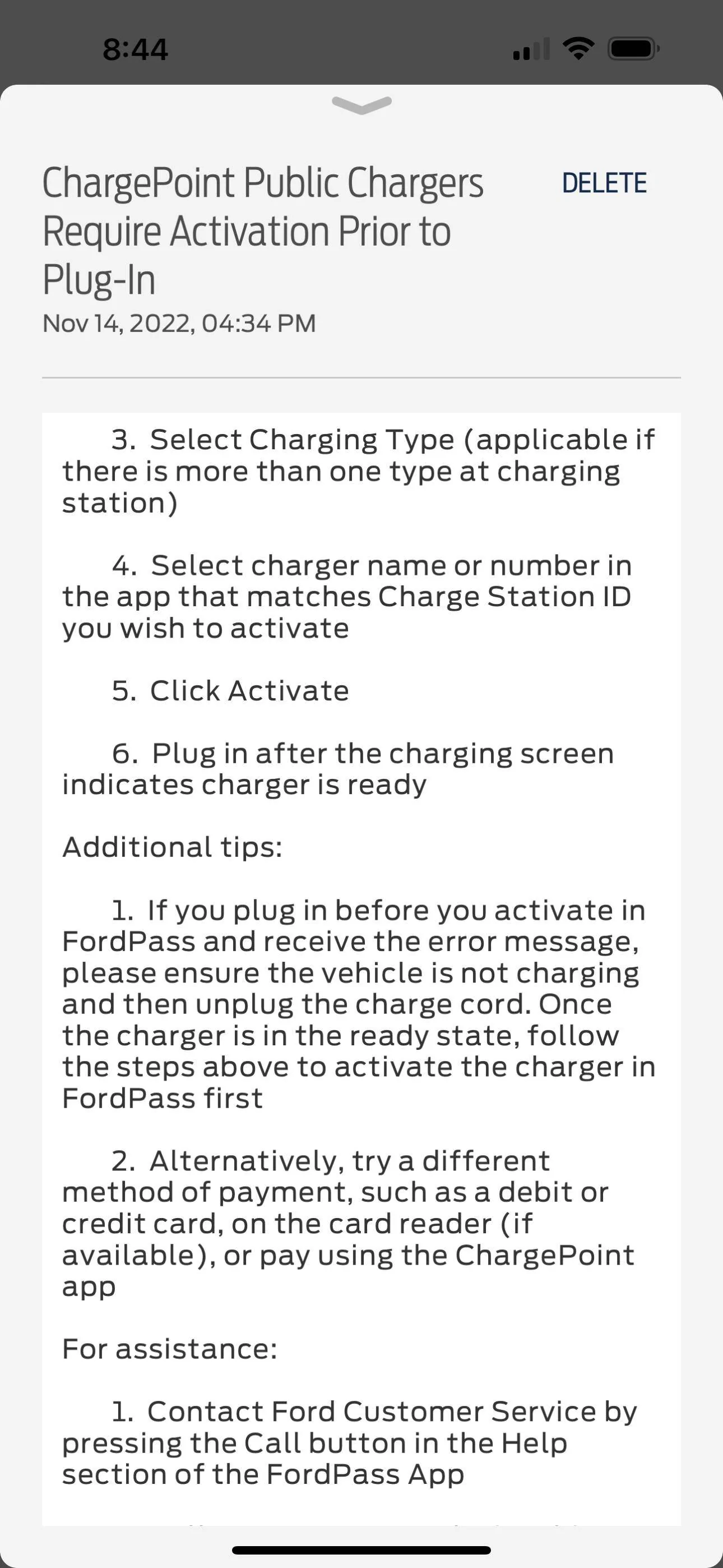

Not sure if everyone saw this, seems like there have been issues with the order in activating ChargePoint charging through the FordPass app:

It’s not plug and charge, it’s blue oval network activation not working with ChargePoint properly if people plug in before hitting activate charger on the app.
