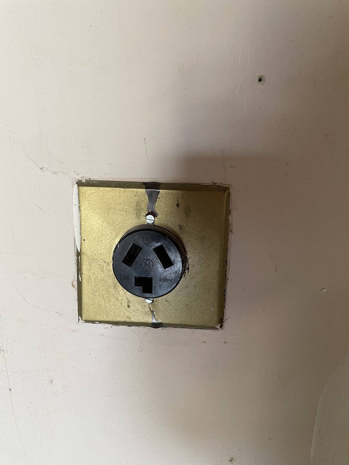

Because I am in a rented house and the owner won't allow modifications...

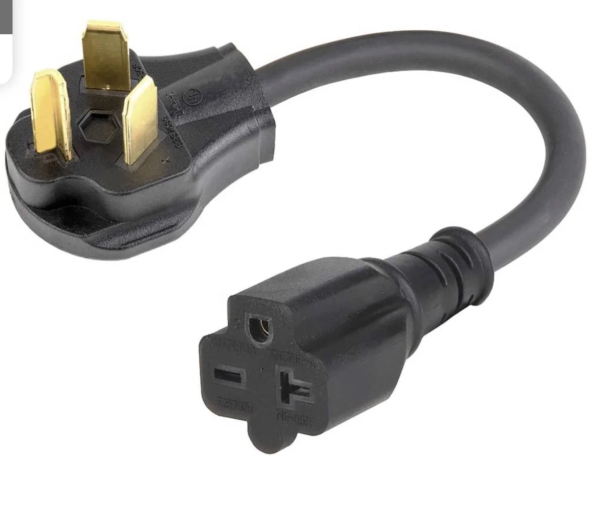

Does he allow house fires??? Lol Sorry bad joke, but using adapters is just not safe. Plugging into it without having a professional double checking it is also incredibly not safe for yourself.
Can you YOLO it, sure, do people do it, absolutely. If you are willing to take on the liability then more amps to ya.

Ok, I took the advice of the posters here and got a 14-50 plug installed, thanks a ton for your posts. Long story short, the electrician was able to use an unused pool electrical circuit (50 amp) and wire the 14-50 receptacle. However, the pool circuit had a neutral wire that was cut. He said that it’s not a big deal, as it’s grounded. First question, is that an issue? Secondly, using the Ford charger I’m only getting 20 mph of charge. Is that normal? I had read somewhere that the included charger gives you 30 mph….
For your first question, it is a bit odd to wire a 14-50R outlet without a neutral, and it is technically “wrong” since some 14-50 devices use the neutral for a 120V internal circuit. However, for your EVSEs it is just fine - none (or almost none) use the neutral, and the Ford mobile charger definitely doesn’t (I’ve tested). The ground is what you need for safety, and the two hot wires for powering the EVSE.
