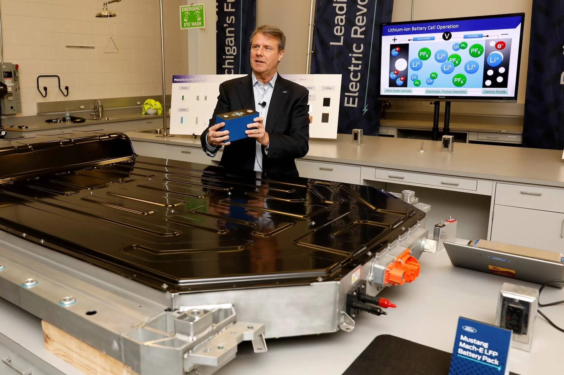

I believe I’ve previously read that all Mach-Es, even the standard range ones, have the physical space for the extended range batteries, but that this space is simply not fully used up with the current standard range batteries - empty space below the rear seats for the standard range models.
Might that explain some or all of the higher battery capacity than anticipated? That these new batteries make better use of the available battery space on the standard trims?
Yes, this LFP pack will use the bump under the rear seat to increase capacity, which is currently empty space on standard range vehicles.
Ford Mustang Mach-E New Mach-E LFP Battery Specs Revealed ford-battery-6-jpg
