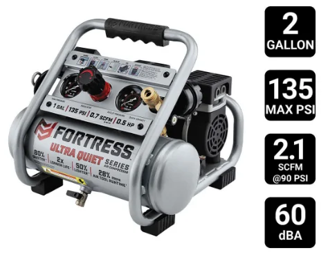

I bought one of these at Harbor Freight and set a reminder in my phone's calendar to check the tires in both cars once each month. I could have gotten by with the 1 gallon version, which is currently on sale.

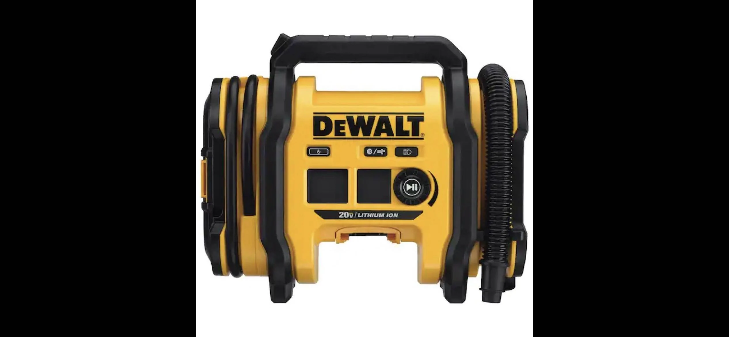

I have something similar, but NEVER use it anymore for tires.
They’re too heavy, loud, cumbersome and slow.
Once I got this portable lightweight battery powered one, I never use anything else for tires, pool floats etc.
You screw it on to the tire valve stem, choose the exact psi and hit the start button. Everything else is automatic.
