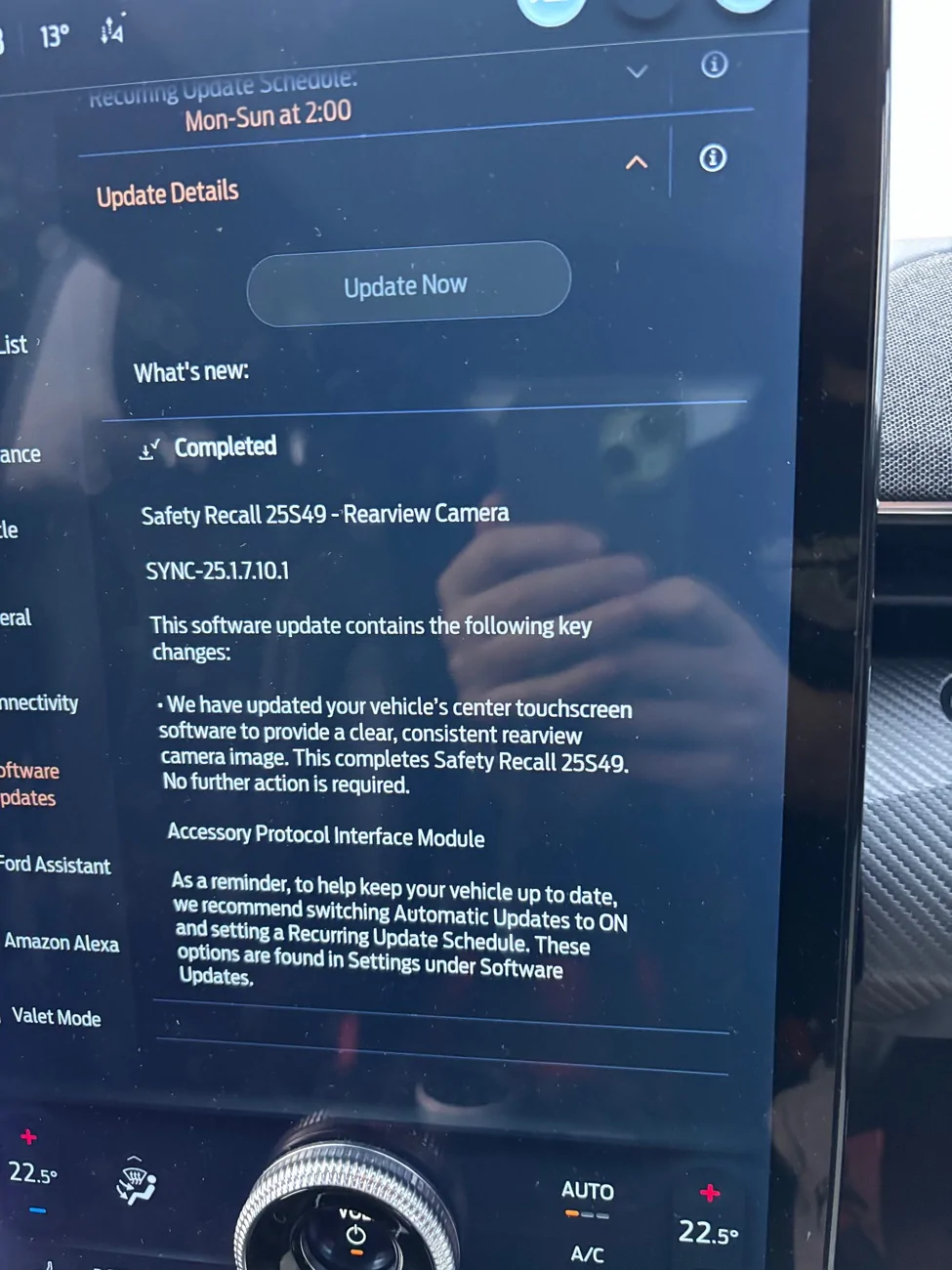

I've attached a photo of the update if it helps, hope this at least gives you hope it, I lost it after month 6 then this happened :).

It's currently:
SYNC 4 Software Version: 25255_PRODUCT
Revision: 2094
Before my spirited drive it was:
SYNC 4 Software Version: 23095_PRODUCT
Revision: 807
That seems like a massive jump, I'm starting to think it's that recall 25S49 is what caused everything to attempt updating again.

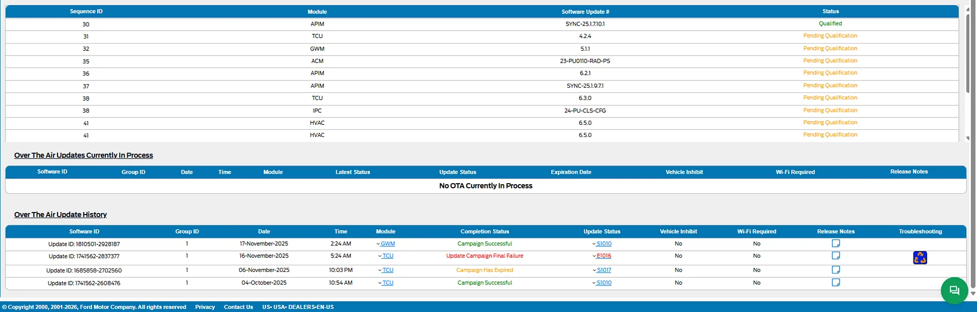

I think this may be a band-aid update Ford is pushing out to address the rear camera recall. Something similar happened on the F150 forum recently. Vehicle was skipped over a bunch of Sync version and ended up on Sync 25255, but then more updates were applied which took the Sync version back down to an older version.
In the case of @Mikey_B, his APIM is currently on the EF strategy which is old. OTA dashboard shows he still has a bunch of old OTA's in queue including more APIM updates. Sync 25211 shows NS in the F188 location.

In your case @Matias it shows the OTA you got is still pending and that you're still on Sync 23095 which is very weird.
Ford Mustang Mach-E No OTA updates in months! 1774117018360-fm
No matter what, updates are still a good thing. However, don't be surprised if a future update brings your Sync down to an older version before it goes back up. I have seen this happen to a few 2021 F150s, so looks like it will be more of the same here.
I don't think this will happen to any other Mach E's other than 2021 and maybe job 2 2022's. Hard to say exactly.
Scratch that. It is possible that 2023's shipped on 2022 Sync versions and it could also happen to those.
