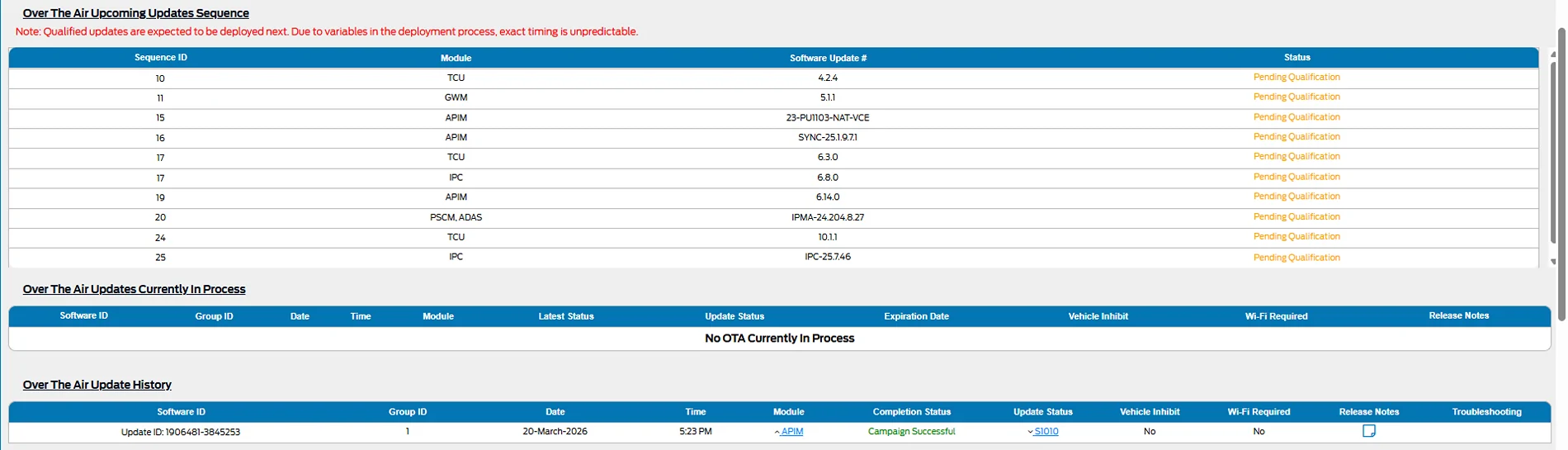

OTA 4.2.4 is for the TCU so that won't change the Sync version. Only an APIM update will do that. 4.2.4 has not cleared from the list, but you now show 5.1.1 for the GWM as qualified. After that comes an APIM update.

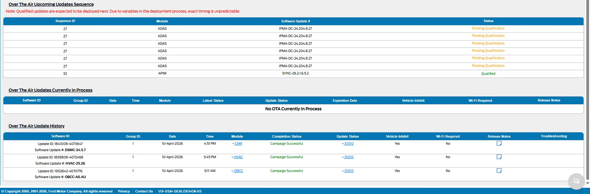

I have 2022 Premium (3FMTK3R73NMA19277) and have been on 10.2 since August of last year, no updates since.
Car received what I think was 3 updates back to back. It happened so fast between short drives I was not able to catch the update notes (I usually take screenshots of the app).
The last update showing is DSMC-24.5.7, Priority Update Driver Facing Camera.
These are the updates you got. You show an APIM updates as "qualified" so that one will be next, but no way of knowing when they will actually send it.

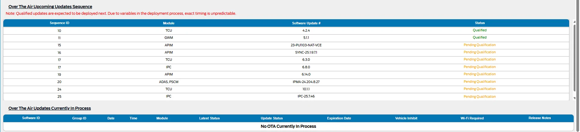

Is the Ford site up again? If you have a moment, could you possibly see if mine is reporting any new updates as Qualified? VIN is
Yea, you show GWM update 24-PU0102-SVD-FX as qualified.
