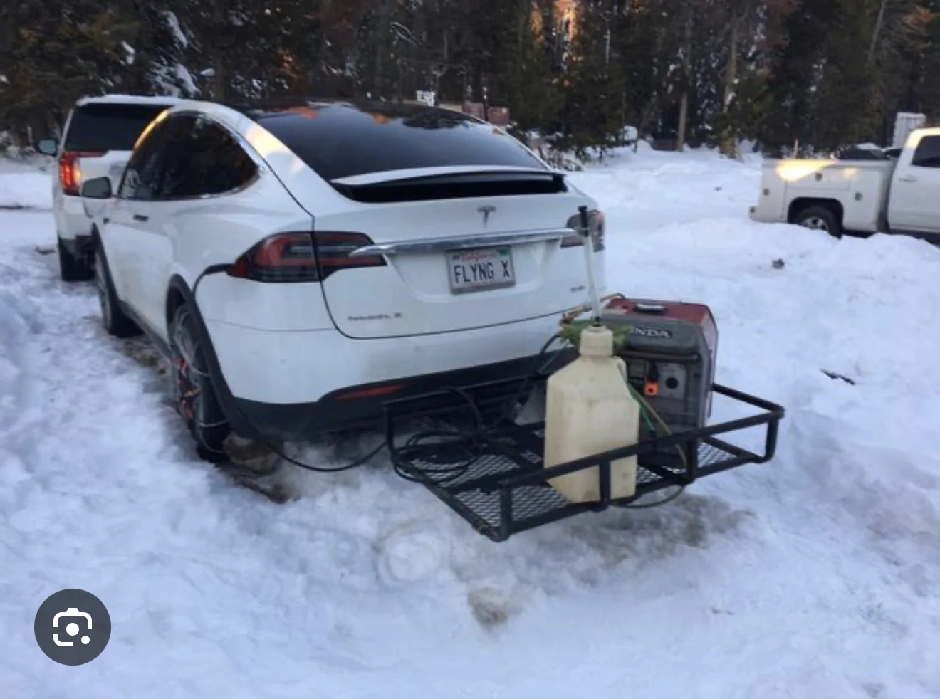

I am travelling to a place that will have to plugs. I’ll just have to charge before somewhere before. I was hoping there was a portable charger
You mean like this?

A few corrections.
Most people rarely get more than 3 miles per kWh unless they are driving slow.
The Mach-E charges at 12amps, yes, but 1.4kW is the gross. Net to the vehicle is 1.1.
I don't know what you meant by "A complete charge will be over six hours". If you mean the 4kW power source, that will be exhausted in 4/1.4 = 2.86 hours, and most people will then be able to drive 2.86 x 1.1 = 3.14kWh x 3 = 9.4 miles or so. Really slow, maybe 50% more.
In short, there really are no off-grid charging solutions absent solar on a house that is off-grid. Setting up a massive portable solar charging setup yields very little.
