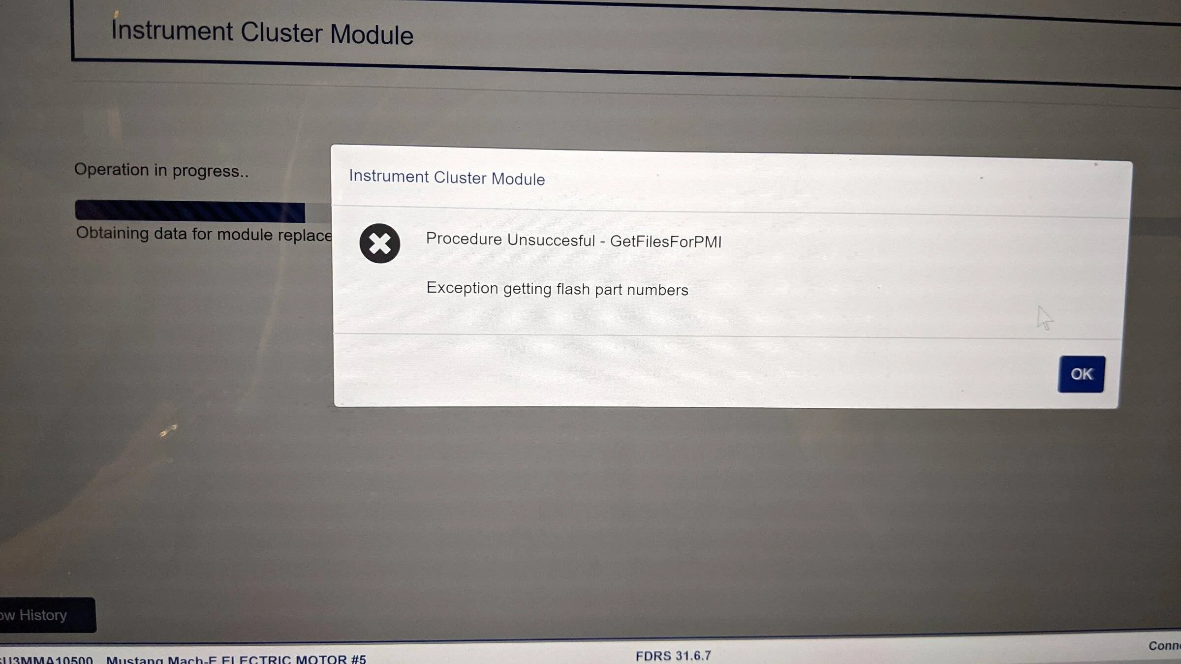

Well, this is now becoming an obsession for me, and a refusal to admit defeat on principle. After rereading this thread (and the ECU programming thread on the F150 forums) I bought yet another FDRS license.
At the very least, the GWM and TCU appear to be fully updated based on version numbers posted here previously. I tried to do the PMI operation on the IPC since that appears to be a version or two behind, but I got this error several times:
Ford Mustang Mach-E Optional Product Improvement Program 21G01 - BlueCruise Programming PXL_20220427_012243141
I can't find anything explaining this. There is some fellow on the F150 forum thread who had an identical error, but he just had to wait a few days apparently? The original set of updates was with 31.6.5 (before .7 was released) and it stuck around after I finished the first one. I couldn't tell if it was a new update or stuck old one, so I repeated it and despite a code brown moment (laptop crashed) I could still configure it and got no error codes after performing a network scan.
I just uninstalled (and reinstalled) 31.6.7, but it's too late for me to run out and try again. Anyone have any ideas?
