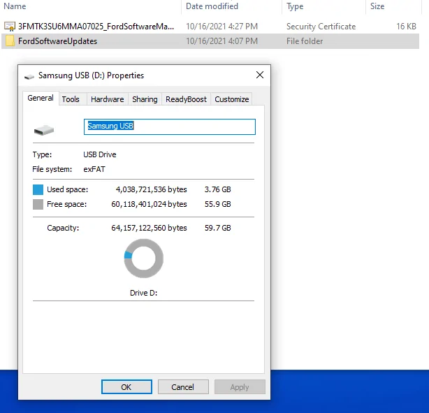

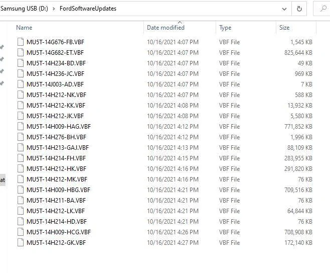

FDRS reported 3GB when I downloaded the update. I think an earlier poster reported success with a 16MB flash drive.After updating all other modules via FDRS, Im stuck with the APIM. While others have stated that the APIM download is about 9GB, I only seem to be downloading 3.3GB, multiple times with different devices.
And each of those devices comes up with the dreaded "USB Error" after about 10minutes into the process.
I do have the VIN numbered file name, so not sure if my download is incomplete in some way.

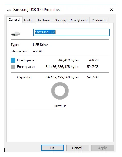

Another user ended up using an external hard drive. @mpshizzle IIRC.@louibluey , thanks for confirming that the APIM download is close to 3GB. I've used a 8Gb, 16Gb and a 32Gb stick. Looked at file sizes to confirm that they are all the same. Perhaps I should check the md5 just to be sure.
Also used a Sandisk media hub that shows an exFat device via USB. All end up with the USB Error.
Not sure what other things to try...
Here are some screen shots showing samples of my Sync update:@louibluey , thanks for confirming that the APIM download is close to 3GB. I've used a 8Gb, 16Gb and a 32Gb stick. Looked at file sizes to confirm that they are all the same. Perhaps I should check the md5 just to be sure.

I did use a 500Gb SSD external drive that worked fine…..however…to fix the USB error, I had to completely clear the FDRS cached files so it redownloaded them again. I can only assume one file got corrupt during download as the same drive worked second time around after this.yes, I think he reported using a 500GB SSD drive that worked.
