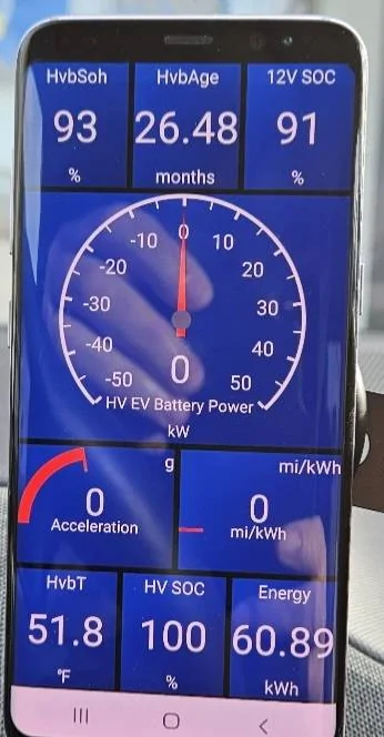

When I was concerned about 12V battery, I bought ODBII and now I monitor it directly in Car Scanner.
P.S. 12V SOC (maybe) is here - https://www.ford.com/myaccount/account-dashboard Thanks, @Mach-Lee, for putting in your thread!

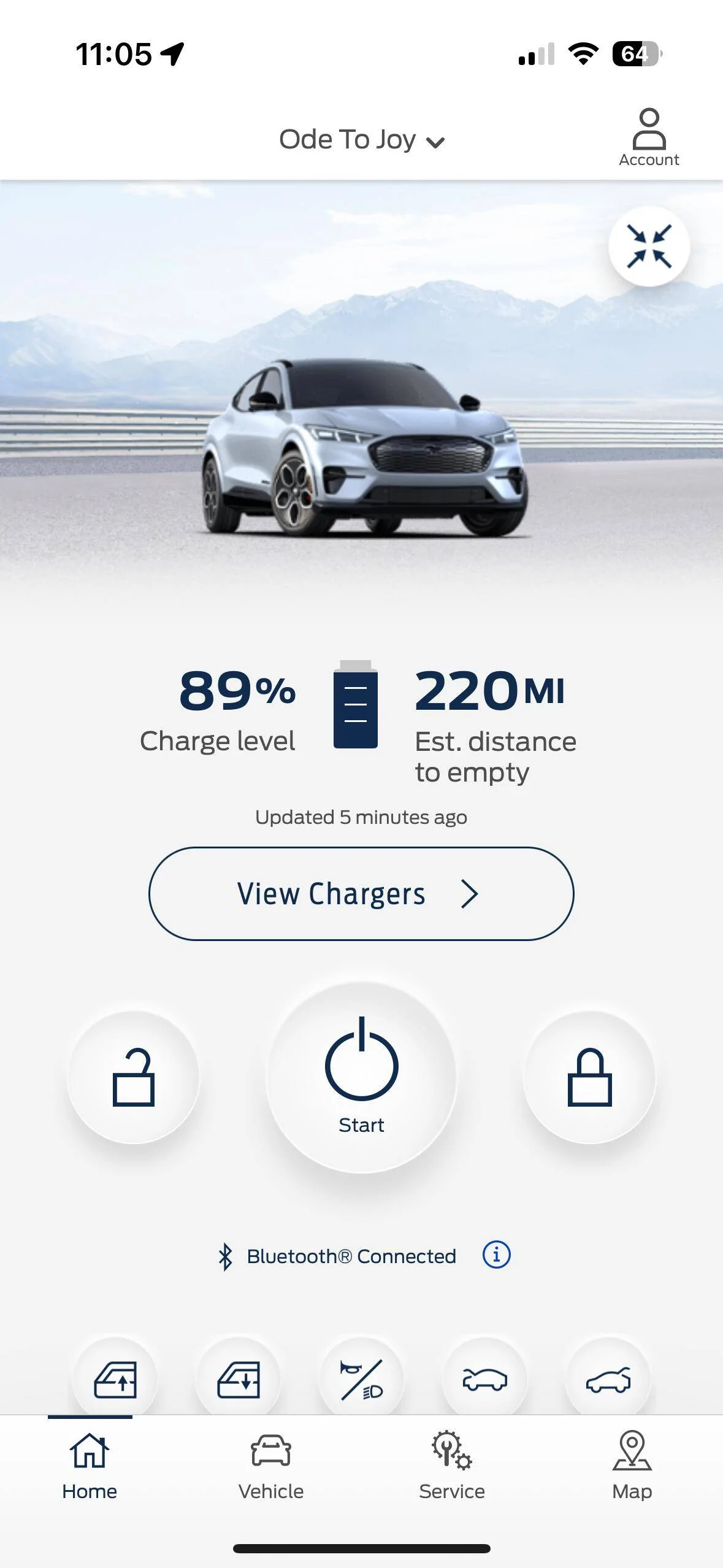

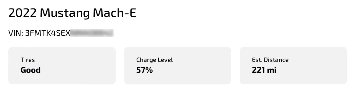

The 93% shown immediately above is actually the 12V battery level. Ford's been doing this for at least a few months. It's odd and who knows if it's intended. It's certainly confusing.
As an example, my MME's LVB is currently only 57% :
Ford Mustang Mach-E OTA updates issue Screenshot 2024-01-29 at 10.58.41 PM
Meanwhile the HVB is 89% SoC:
Ford Mustang Mach-E OTA updates issue IMG_2375
(I also am seeing car not found when I click on the health report. A server must be down.)

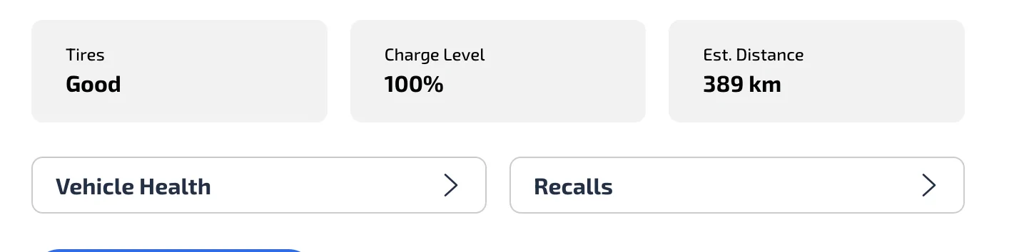

Sign on to Ford.com and go to your Account (not the dashboard). The first screen looks like this:
Ford Mustang Mach-E OTA updates issue 1706629778244
The Charge Level is actually the 12v SOC on this screen.

Needed the same.... ;-)
How does it know my tires are "Good"? Must just be reading the odometer and assuming I haven't changed the tires yet?
