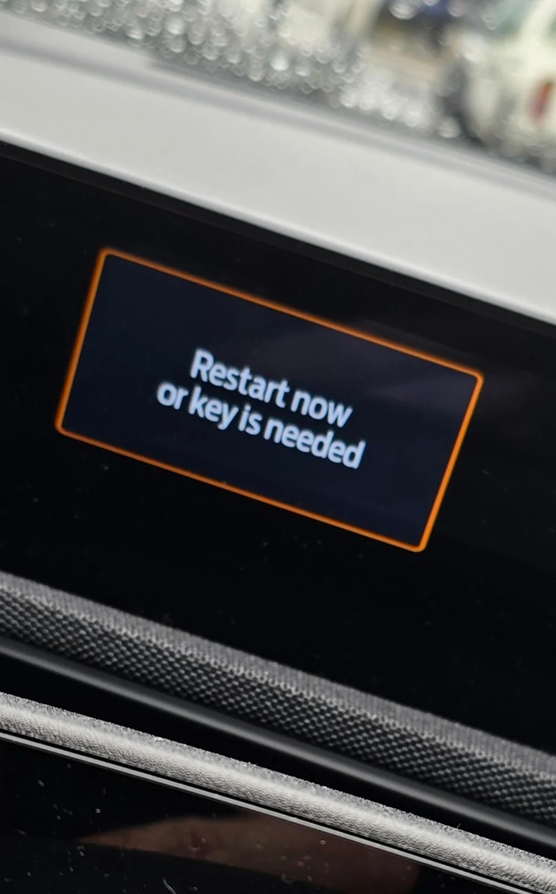

Well Verizon was out of service here in Florida and other parts of the world for about 6 hours today. The Ford Pass app would show some things but it wouldn't show others. Couldn't lock or unlock doors but could open frunk and trunk/hatch.
It wouldn't show anything at the top of the app screen like my vehicle mileage or any specific info. Overall was having trouble with the PAAK being a PAAK.
So I was forced to go into my faraday pouch in the secret hiding spot duct taped to my glass roof. And I suffered using the key fob like it was 1999.
Even though the internet service was down my phone Wi-Fi NFC Bluetooth was all working fine. But I was driving mom around shopping so I didn't have time to play around to see if PAAK could have worked.
Some of this issue could have been my Galaxy s24 functions when the internet's down? Overall it wasn't showing the lock unlock buttons so I don't think I had any workarounds?

Edit: I was already in the car the PAAK failure started while I pulled up to a parking lot. Verizon cellular went down and I saw a weird message on my dashboard.

Ok thanks that's great to know. The weird thing is I was in my car when the internet failed so I made an assumption based on that. In fact, the dashboard had message telling me I wouldn't be able to start the car if I walked away. So that momentary panic caused me to forget all my options and grab the key fob.
Had it happened while I was in the store I might not have even noticed. Especially if the car is going to still unlock with the phone connected by Wi-Fi and Bluetooth despite the cellular outage.
The "Restart now or key is needed" issue has nothing to do with internet connection. It happens when the car is shut down and during the shutdown process the BT signal to the PaaK or physical key is lost. I just lock the doors, close them, and walk away. When I come back everything is normal. It happened to me yesterday at the store and I had zero issues restarting the car and getting home. 🤔🐩
Lol this thing has become a comedy of errors
If I didn't see that message I wouldn't have checked and see that my phone internet had no cellular signal. I wasn't initially worried but grabbed the keyfob. Then using the store's Wi-Fi find out that Verizon had a nationwide outage.
If I didn't grab the phone as a key I probably would have used the door key code because sometimes that's faster than waiting for your phone to relink to the vehicle even with all connections functional
I guess there's good ways to learn and then the more stressful I'm actually in an emergency situation and this thing needs to work way to learn

The car pings your phone right when you turn it off, if it doesn't respond immediately then that message is displayed. I get that occasionally, but it's a rare glitch with PAAK that lasts a few seconds, you should be okay to keep using it if your phone still has bluetooth active and FordPass open.
FYI I've been fob free for the past 3+ years, I've had to use the backup passcode only once or twice when it wasn't working. I've had cell towers fail at least once, I can still operate the car normally. Never been stranded or locked out yet. Still worth not carrying an extra fob to me, but opinions will vary.
