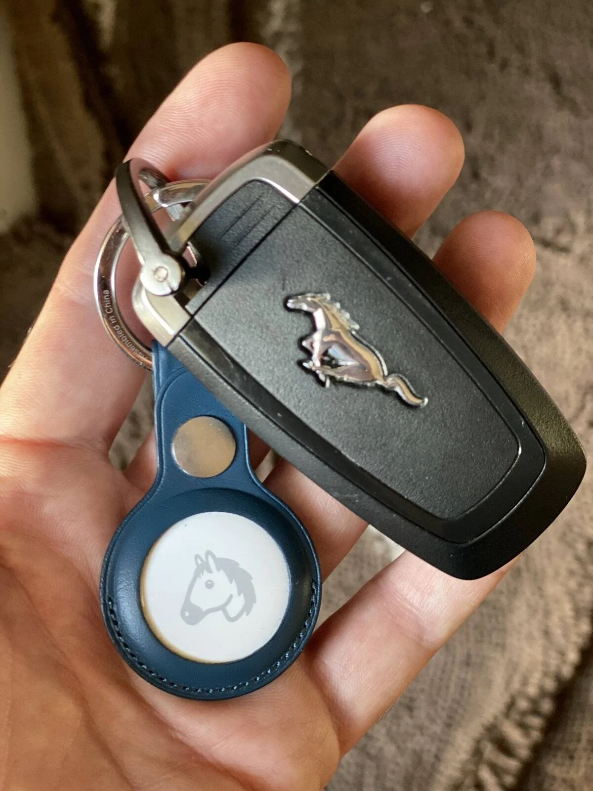

If it doesn't work 100%, it's not a good alternative to the fob. I disabled that crap and never looked back. I personally like the ritual of grabbing my Mustang keys (fob) and going for a drive. With an AirTag, I don't lose them either. ?
