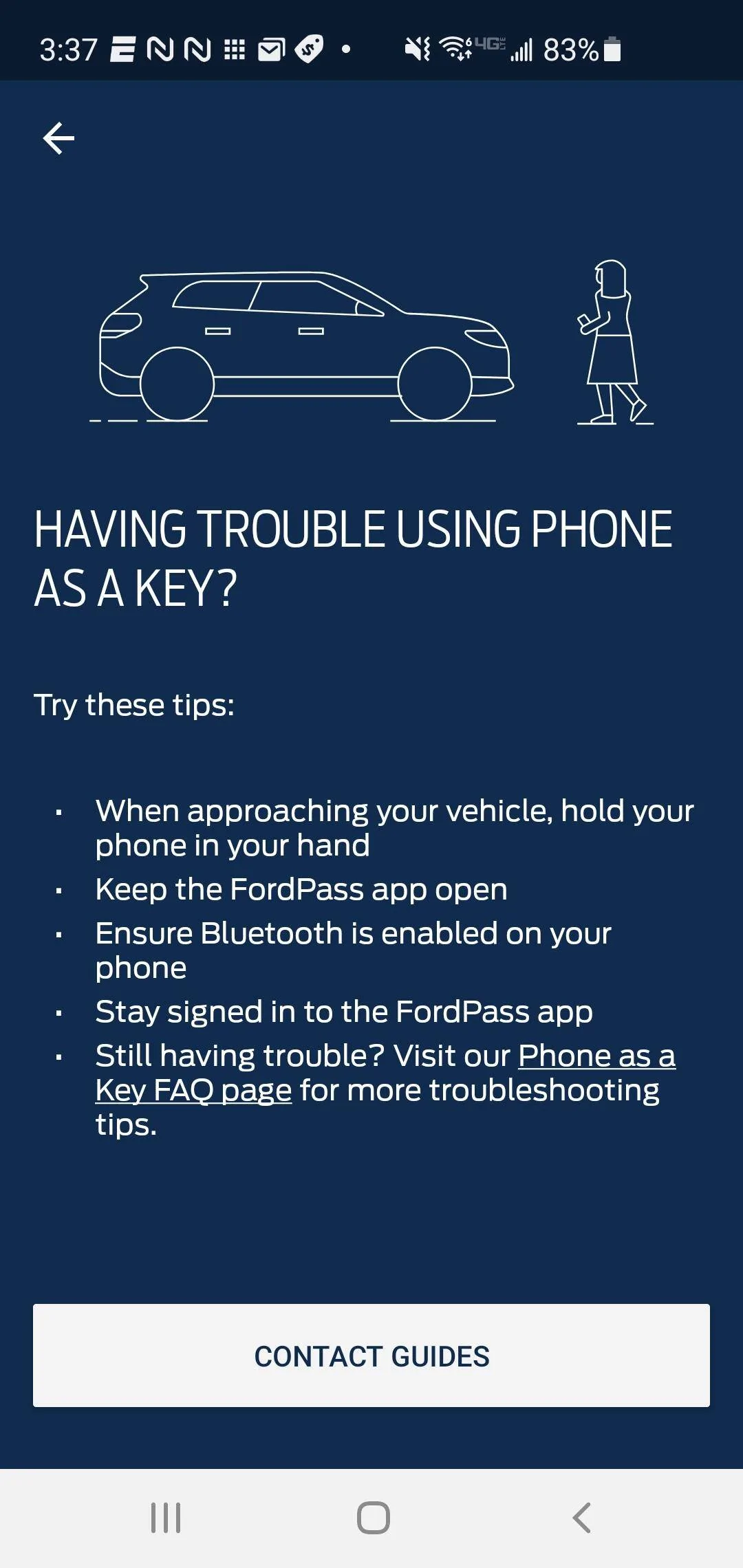

Hello fellow Mach-E owners. I'm wondering if anyone is finding that their Phone As a Key is working consistently. I've experienced it fail, like, often... maybe it works 1 out of 10 times. Most of the time, I'm entering my door key code, and back-up start passcode. I've learned not to depend on it and rarely go without the key fob these days. I'm using an iPhone Xs, latest IOS (16.1 -although it didn't work with any previous iOS version). I have the latest Mach E software updates, and latest FordPass app. Curious if anyone got it working to a point that they use it often. Or, if anyone has had similar problems and was able to fix them? Thanks in advance!

I don't know anyone who claims PaaK is 100% reliable but many users find it good enough for their needs. Your failure rate sounds very high compared to many others. A while back, Ford sent me some tips that are supposed to help. I haven't tried these things because I had already switched back to the fob by this time.
