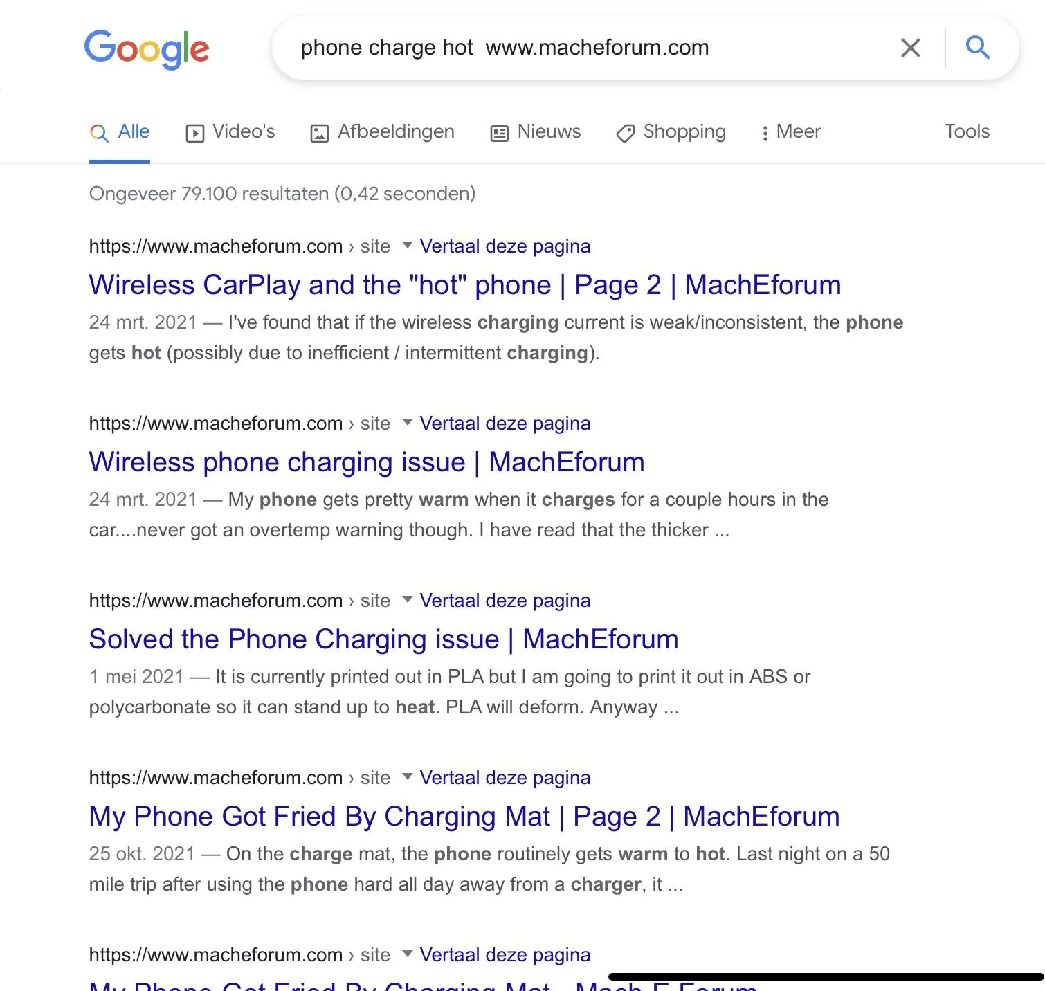

Lots of great information in several threads here on the forum for mitigating this issue.
This thread may be of interest to you: https://www.macheforum.com/site/threads/my-phone-got-fried-by-charging-mat.10682/page-2#post-457337
I made a couple posts to that thread as I discovered things but the gist is: I find my phone which is in a thick, rubber-surfaced case does better when I remove the rubber mat/devider from the phone charging tray. I think the combined thickness of the case plus the mat kept the phone too far from the charging coils, and the non-skid properties of the phone case make the rubber mat unnecessary. Your experience may vary.
