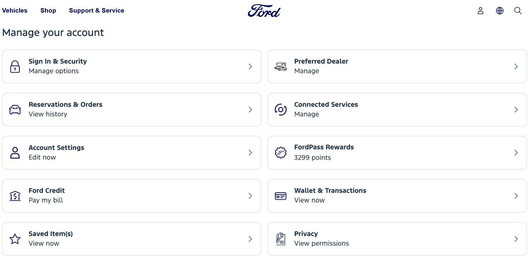

It has to be set up first, in Connected Service. Plug&Charge has to be toggled on, and you have to have a credit card registered in your Ford Wallet. Sometimes takes a little time for that to all go through and be ready for a charge at a station, but you only have to set it up once.
