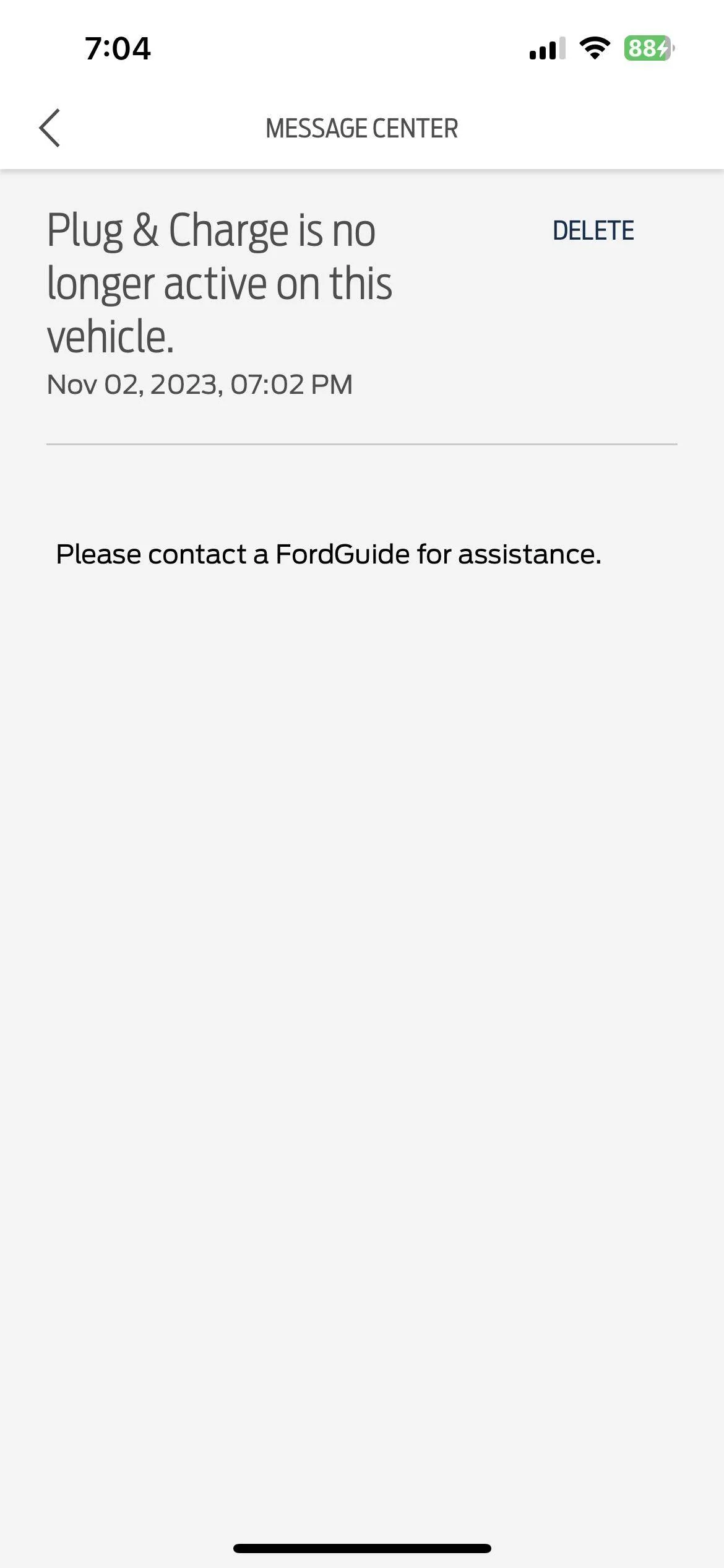

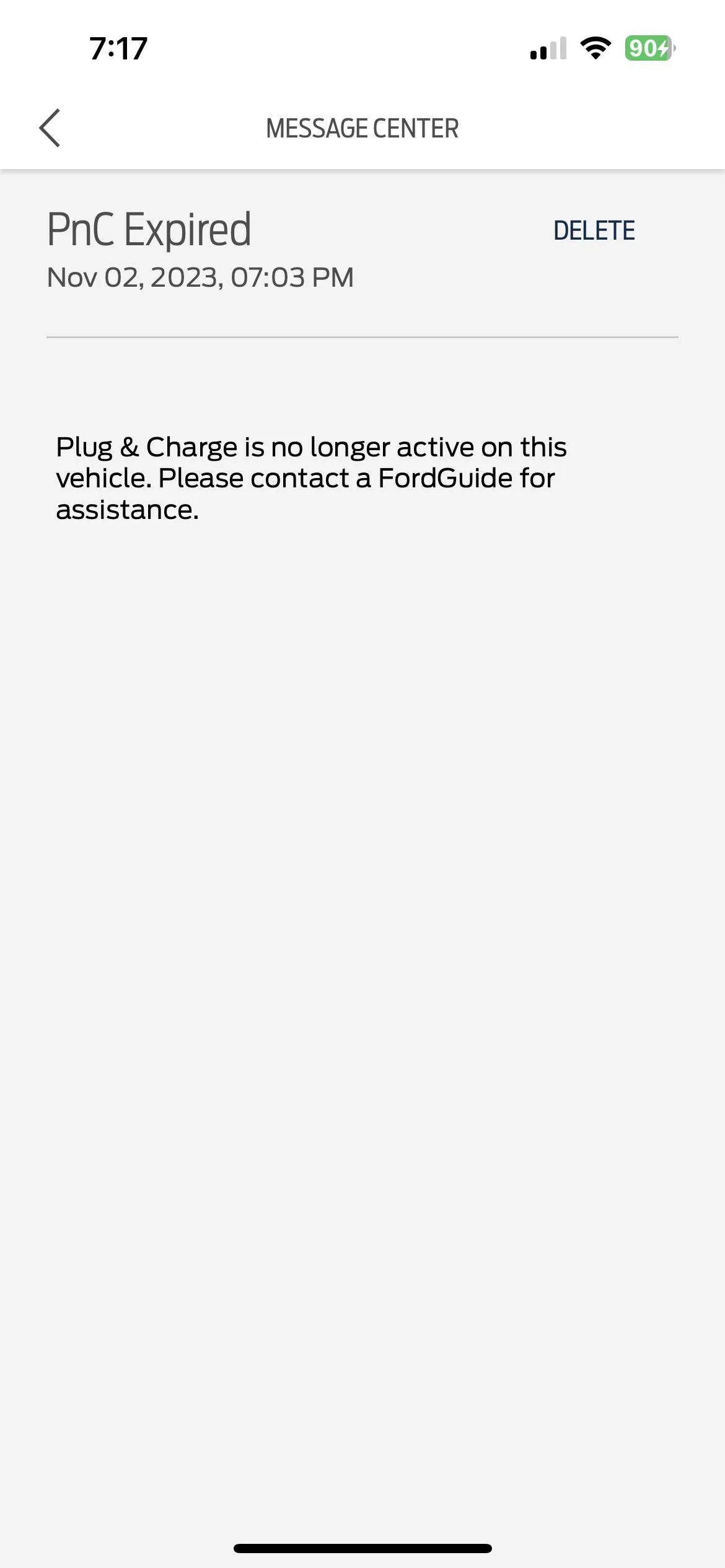

Just got this message as well as one that said “PNC expired,” which isn’t true since I’m good for another year according to the app.
Checked payment and it has an old credit card I cancelled listed (cancelled not expired).
I’m guessing it’s payment related. But if so, the alert should say so.

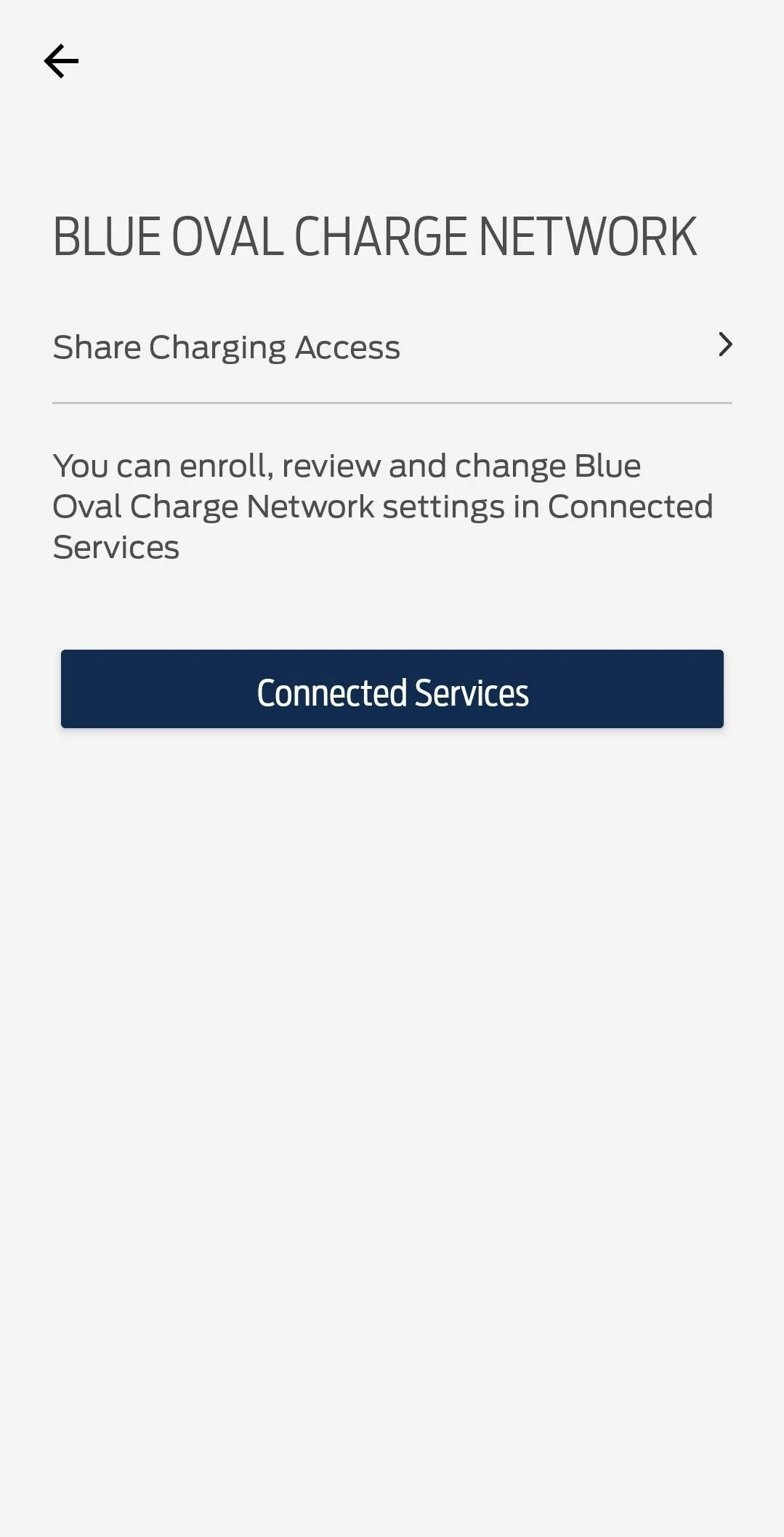

I got the same error.
But I cant follow the same path. When I click on Blue Oval network all I see is the attached screen. But in Connected Services, BlueOval is ACTIVE.
Should I be seeing other content?
