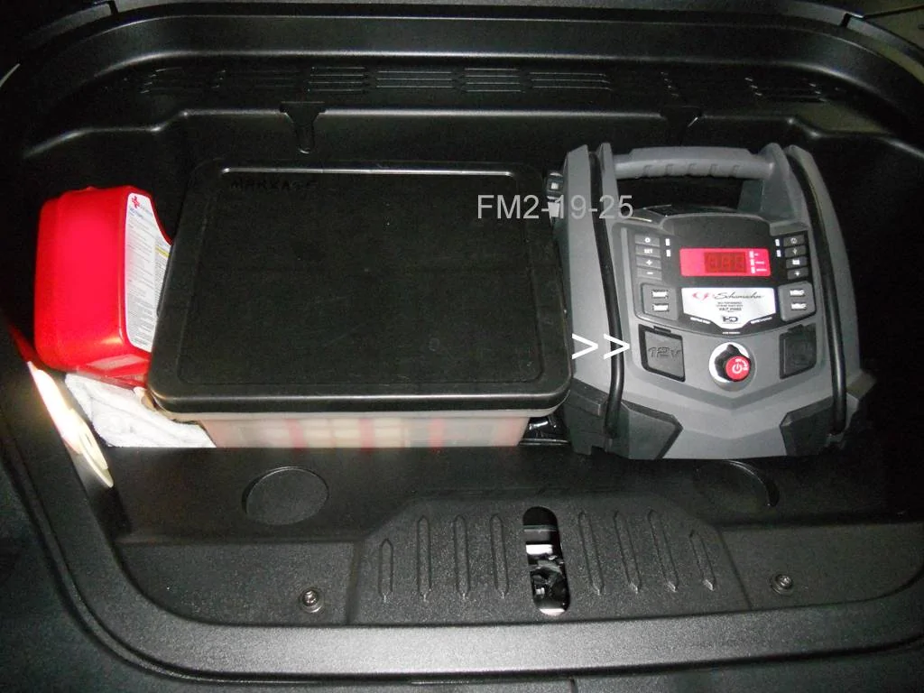

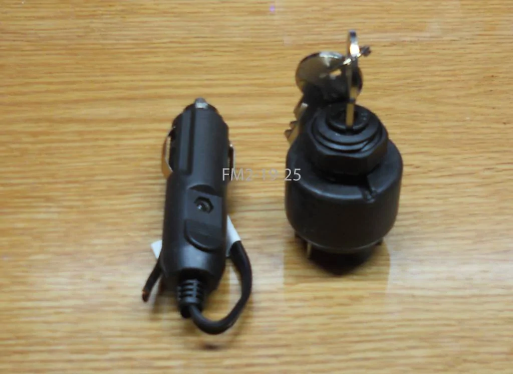

I am working on a plan that uses a jump starter (from my former ICE car) that has a 20 Ampere output. A connector will be used at the 12-volt output that will be fed to a key switch. The switch will control the power that will be routed to the emergency jump start circuit either directly or by plugging it in to a socket at the front access door. I may connect it to the battery as an alternate. A 20 Amp. fuse will also be installed. I am trying to determine the best place for the switch. I had considered the charging port area since it has weather protection but, there isn’t enough room there. I may have to get a better switch to handle all weather conditions if it’s on the body.
Ford Mustang Mach-E Possible "backup solution" for failed 12-volt battery?? MachE Frunk SW
Ford Mustang Mach-E Possible "backup solution" for failed 12-volt battery?? Switch & Connector SW
