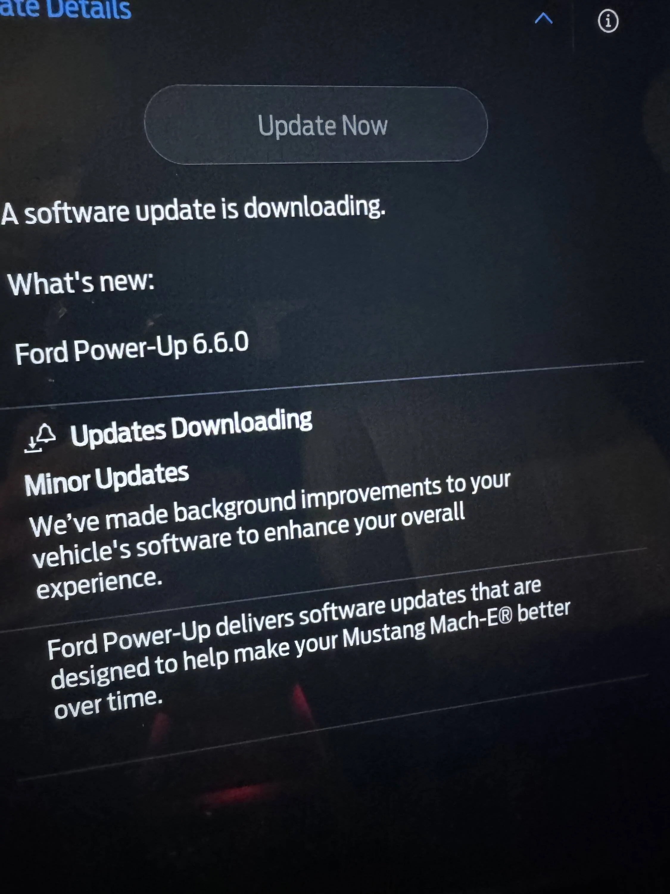

It is interesting to me that 6.6.0 + the latest Voldemort update seems to be the stopping point for my car, lately. Makes me wonder if problems were discovered with 6.7.0 and greater that made the team stop pushing updates? Not a big deal, really. Just surprised me that they went on a roll with pushing my car up to this build and then...nothing more. (Yes, I am in the EA and I double-checked that my car is still registered for it.)
OTAs were suspended for the Christmas - New Year's holiday. Those getting them now had already been sent before the shutdown. I'd expect to see some start pushing next week.
I believe that. I was also surprised by how I was more or less in sync with ChasingCoral's car as we both seemed to be receiving the updates at the same cadence. Again, NBD, truly. Just surprises me to see the way these updates get pushed out.
And yes, it was very smart for them to halt all OTAs for the holidays. I don't blame them a bit for that. :)
