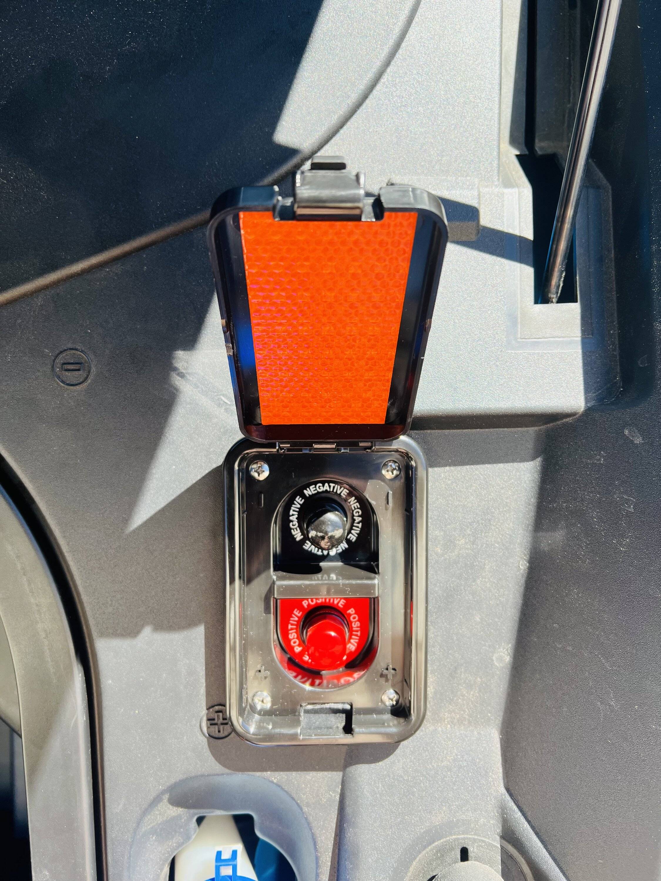

Yeah, our cars’ 12V batteries are pitifully small. The same amount of juice from a traditional Group 34 battery would be in the 5-7% range. I guess I should note that my LVB SoC is almost >95% when I park in my driveway, so I didn’t even think about it. I do occasionally make use of my 12V jump point to charge the 12V, but it really doesn’t need that most of the time I connect to the 12V charger. ?‍♂?
Ford Mustang Mach-E Power Up 6.6.0 IMG_3380

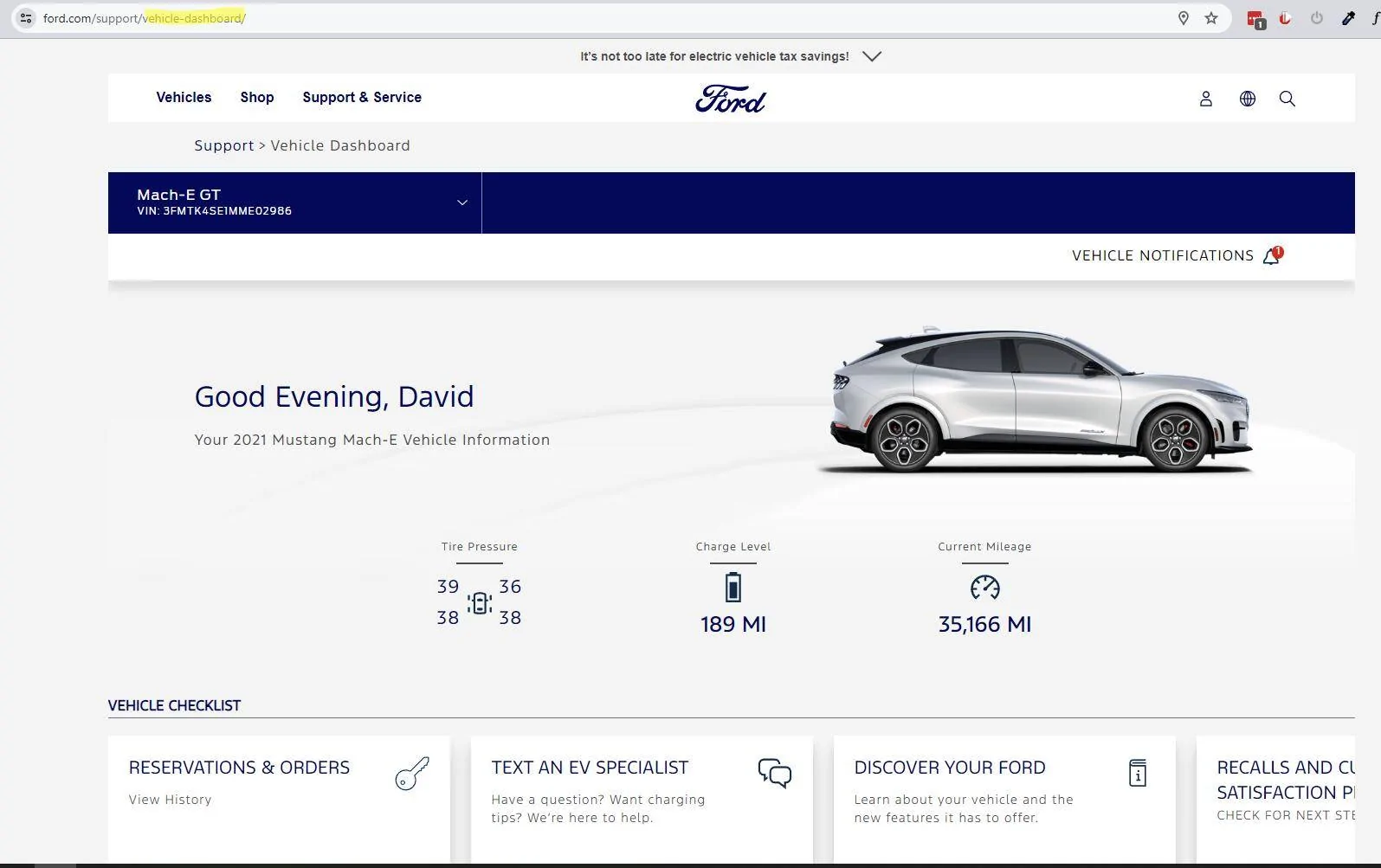

The "Vehicle Dashboard"' is a page on the Ford website. I see the information for my car, but nowhere do I see the 12V SOC. Where on that page would I see any information on the 12V battery? I've looked all over and cant find it. Thanks
Ford Mustang Mach-E Power Up 6.6.0 1702943218706
11,383
25,076
No, just click on the link everyone keeps giving rather than finding it yourself.

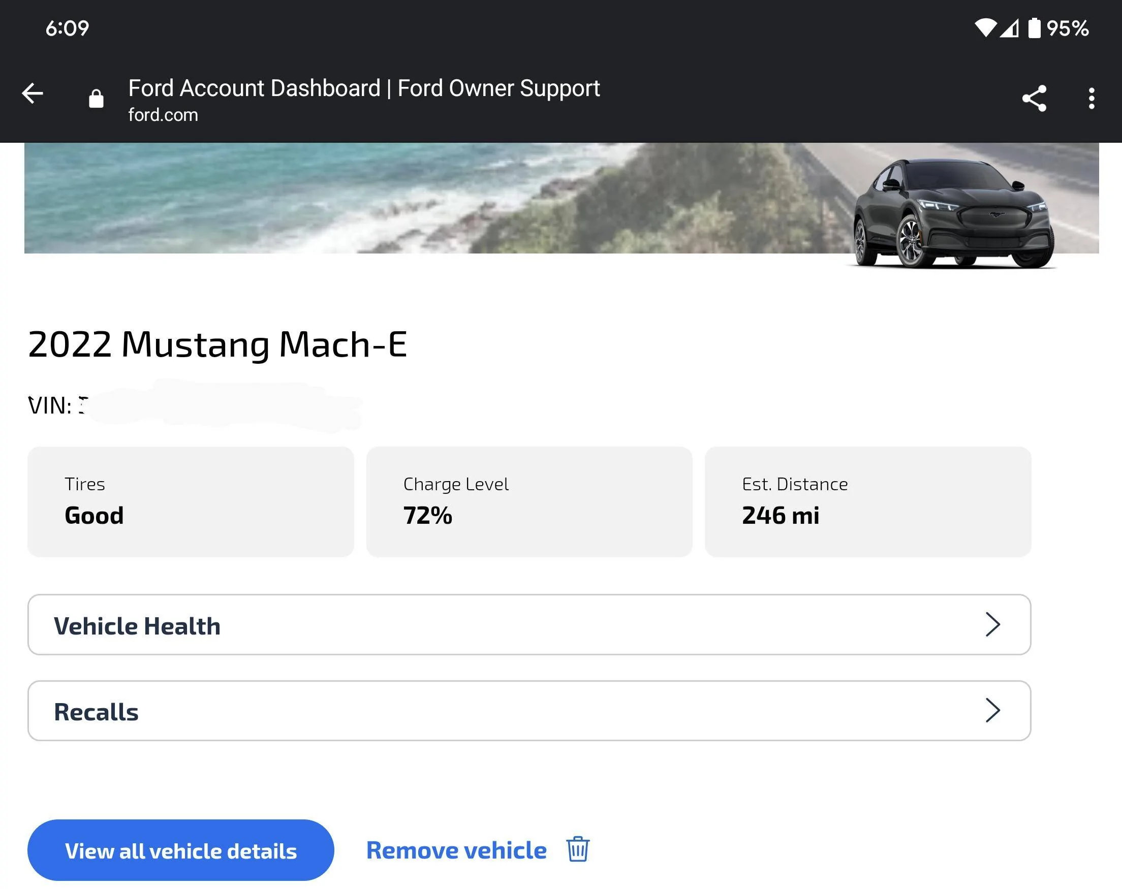

What link? I have clicked a couple links posted in this thread but none of them take me to a screen that shows the 12V state of charge. Can someone post the link or screenshot of the URL that has this info? Thanks.
hybrid2bev
Dec 4, 2019
78
4,642
12,773
2026 Rally
For me that just takes me to the first vehicle in my account which is my Raptor. I can navigate to the Mach-E, but still cannot find the 12V battery SOC. Certainly it's not the 72% shown here is it? isn't that the HVB state of charge?
You would think so, but it’s actually the 12v SOC.
11,418
23,116
That is the LVB soc. Undoubtedly it was intended to be the hvb charge but currently it’s the 12v state of charge.
