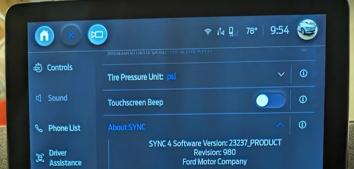

I think doing a factory reset let the 6.2 update go through. I now see a Alexa icon on the top bar that was not there before.
Nope, Alexa was in the previous version, you just reset everything so the icon shows up again by default. Check your version, 6.2.0 is 23237:
Ya still 6.1, but it not showing 6.2 as not completed now :)
