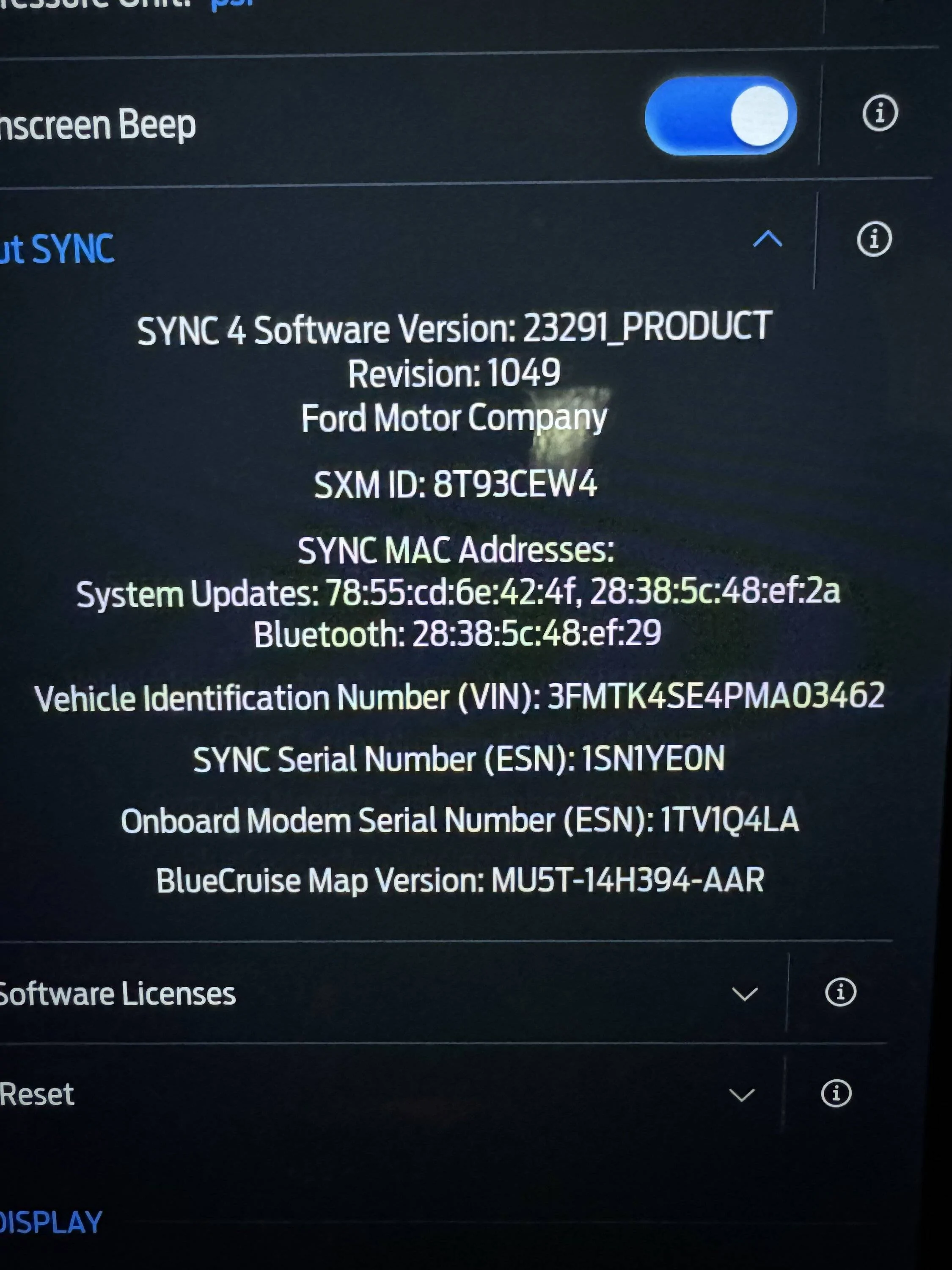

Need a little help.. my car was in a body shop for over a month and I’ve lost track of what power-up version I’m currently on. Can anything be deduced from this sync screen?
The screen info says that you are on at least 6.3 but doesn't tell you more than that. Someone with PTS access could use your VIN to estimate your current software level.

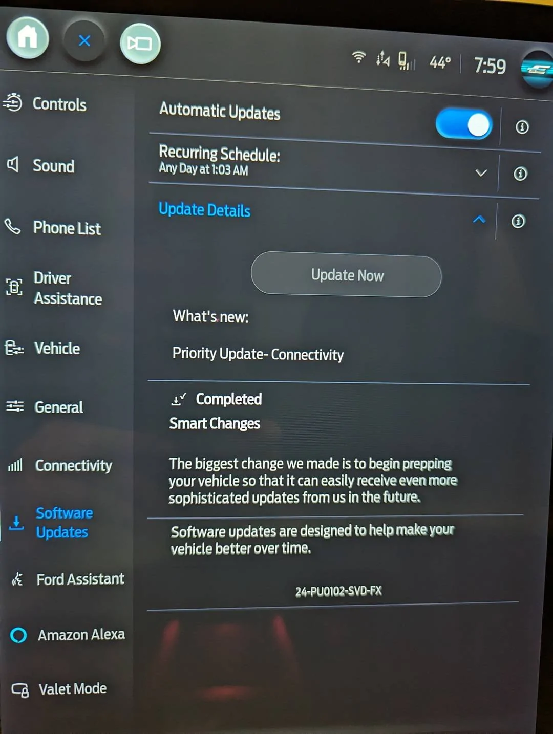

You are looking in the wrong place. Under your vehicle settings go to "Software Updates" and it will tell you the last update your vehicle received. If you use the FordPass app it can also tell you the latest update your vehicle received.
Right. I have the same connectivity update that you show here, but I’m wondering what 6.x version number I’m on.
Sorry I misunderstood your post. I guess I don't know how to help you out.
As I explained above, only someone with Ford PTS (dealer) access will be able to tell you the software level. If sufficiently interested post in the big "FDRS" thread and I'm sure someone will be kind enough to look into it.
