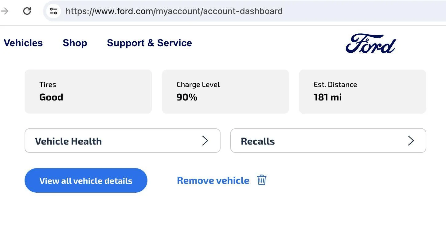

Where on this page is the LVB? I’m not seeing it. Thanks.
It's reported under "Charge Level." This is supposed to be the HVB battery total, but due to a likely mistake as of now it's reporting 12V battery charge. Go to the URL below and scroll down slightly and you'll see it. See mine below (my actual HVB battery charge is 78%):
I see now. When I first looked, it was relatively close to my HVB SOC. Now it’s more clear.

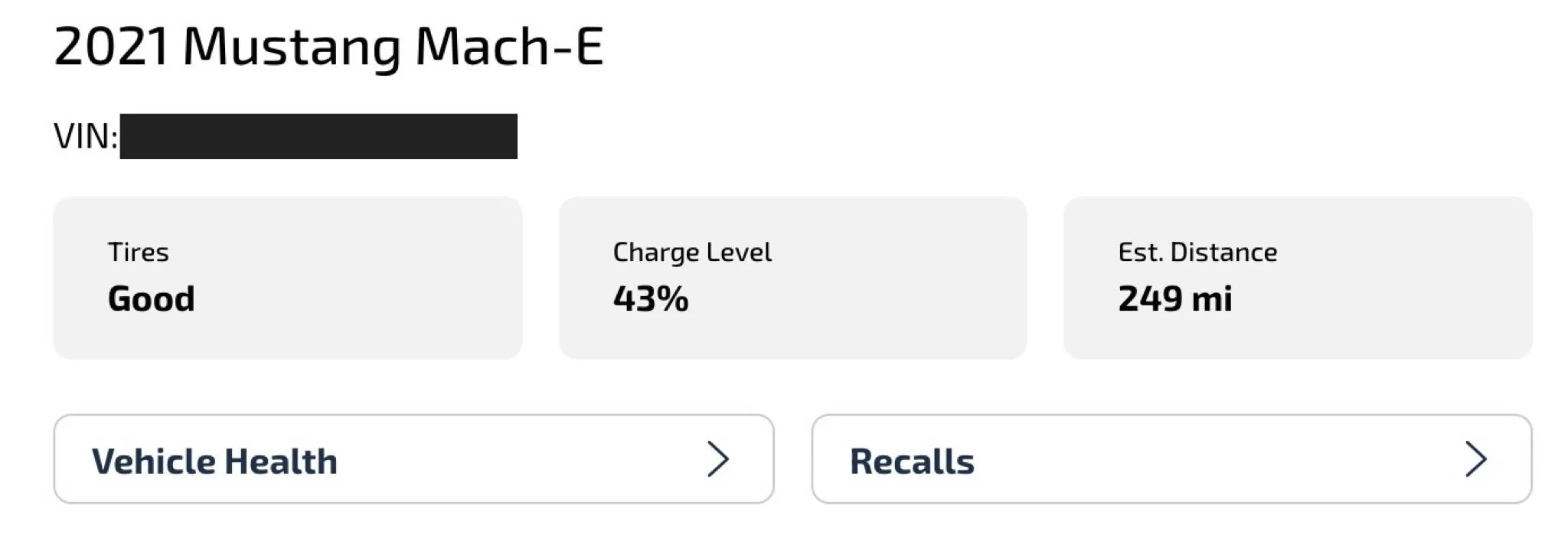

FordPass is reporting my Mach-e is at 90% SOC (charged overnight and I have not diven it today) and its been plugged in all day. Yet...
Ford Mustang Mach-E Power Up 6.x Poll Charge_Level
The 12V is at 43%, correct? Explains the error message for sure.
Yes, 12V is at 43% SOC. I found the 12V only charges when the HV battery is charging. If you have the car plugged in but it's not charging, then the 12V will not charge and will actually continue to drain.
