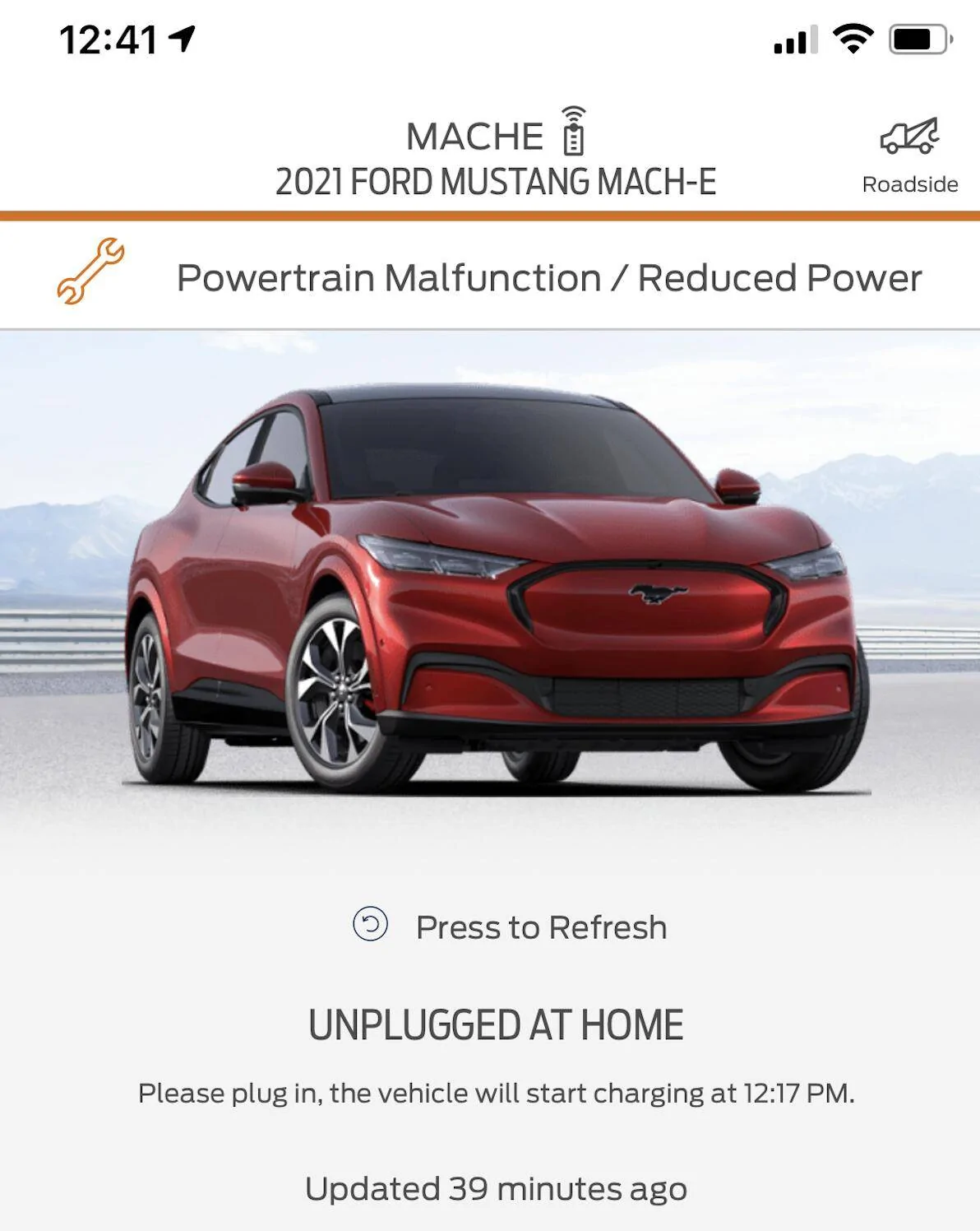

So driving home Thursday night with it being a cool -5 degrees Fahrenheit and the snow beginning to fall, I was sitting at a red light on the top of a hill when the light turned green and I tried to proceed. I attempted to accelerate and the car hesitated and felt like it lost all power and then I received the following alert on the dash 'Powertrain Malfunction/Reduced Power' followed by the 'Service Vehicle Soon' alert. The vehicle wouldn't go more than 1 mph and was jerking horribly. I was finally able to get it out of the intersection onto the side of the road, where I completely turned everything off, waited five minutes and then turned the car back on. Unfortunately the alert was still there. The car seemed to drive mostly fine after that but honestly 'freaked me out' with only 120 miles on the car. I was able to make it home (about 15 miles away) with the alert still on the dash. On Friday morning, I went back out to check on the status of the car and the alert had cleared. I called the dealership and they said to bring it in if it happens again or if I get any other errors. Just wanted to pass this along to see if anyone else has had any "mechanical issues" like this.

Ford Mustang Mach-E 'Powertrain Malfunction/Reduced Power' followed by 'Service Vehicle Soon' alert displayed Screen Shot 2021-02-13 at 12.42.14 PM

So driving home Thursday night with it being a cool -5 degrees Fahrenheit and the snow beginning to fall, I was sitting at a red light on the top of a hill when the light turned green and I tried to proceed. I attempted to accelerate and the car hesitated and felt like it lost all power and then I received the following alert on the dash 'Powertrain Malfunction/Reduced Power' followed by the 'Service Vehicle Soon' alert. The vehicle wouldn't go more than 1 mph and was jerking horribly. I was finally able to get it out of the intersection onto the side of the road, where I completely turned everything off, waited five minutes and then turned the car back on...

My charge port has a constant RED ring which does go away and does come back when the cabled is pulled. Easily duplicated, I now received 3 power train failure notices with one just minutes ago while trying to setup the wireless. For the wireless I can get it to connect to one network but not another (tried the US keyboard with no luck).
I have the same message and get the same constant red ring when unplugging the charge cord.
In the interests of sleuthing, here is what I know I did before getting the Service Vehicle Soon message: I successfully set up FordPass. I then tried to set up the home network connection. This failed several times. Then I tried to set up departure times. That didn't work either but to test whether it was working I plugged and unplugged the Clipper Creek charger twice for less than two minutes each time. The next day I tried to program the garage door opener. It didn't work and during this process I noticed the message.
Later that afternoon the error message disappeared. Figuring it had just cycled and cleared, I again tried to connect to the home network after rebooting it. This didn't work but the Service Vehicle Soon message reappeared.
I wondered if a charge cycle might clear the error code and plugged in this morning and charged to 100%. When I unplugged the ring went red.
I've been thinking that charging is more a casualty than a cause, and the cause is some random error code from the errors when trying to do something else like connect to the home network or the garage door opener.
I had these errors before setting up wireless, I have two networks at home as one is a backup LTE should the primary go south. I am able to get to the backup network which is a cradle point but not my UniFi home AP's. Says can't connect etc.
Glad I am not alone with this issue which means it's not something that only my car is experiencing. While it sucks for us, having company helps our issue become more understood. I still gripe that my smart car needs the dealer to get involved for discovery. I get that I might have to go the dealer to apply a fix but the discovery should be uploaded realtime. I am told that errors are sent to Ford, but still the dealer has to go through the same process. First get the car in, plug a reader into it, call the Ford hotline, run through some tests and see if they can resolve it. First pass of this process was just to reset everything, however the car appears to reset the message on its own and it comes back. Dealer said they tested charing for 10 minutes and didn't get an error. I can duplicate this at home each time and I tried with three different chargers that I have. They should have seen the error reappear but it didn't for them or they cleared it and sent me on my way. The powertrain message coming up three times is most worry now since a member got briefly stuck.
Yes you definitely don't want to be alone. Herd is the way to go! LOL
I'm not convinced that our issue is the same as his. His seems powertrain related. Ours not so much. It may be -- and I'm thinking it is -- that many different issues throw an error code that triggers the "Service Vehicle Soon" message. In this case the message alone won't tell you much.
My plan is to make an appointment, at which I'm sure they'll just clear the code. After that I'll avoid trying to connect the MME to anything but will plug in. If this triggers an error then it might narrow down the possible causes to charging. One wild idea might be that my Clipper Creek charger doesn't support 120v and this creates an issue ending the handshake. You'd hope this wouldn't be the case since the charger is standard and it's so easy to check.
