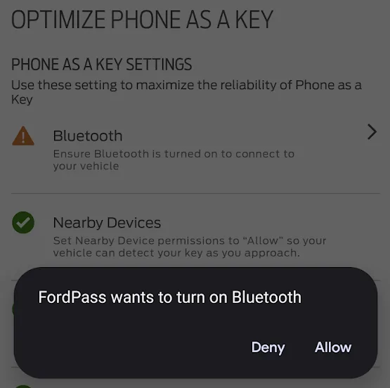

Ok so anyone who has a P7/P7P should be aware that the March security update might boink PaaK. The most reliable way I've found to get PaaK working with this update as a momentary solution is to toggle BT on and off and then immediately open FP. It will connect and allow you to drive away. It will disconnect within a very short period and you'll have to do the dance again at the next stop to open the doors and start the vehicle without a code.
My exact experience (as posted elsewhere around these forums) since the March P7P security update. I have a similar workaround where I keep FordPass open, turn off BT from the P7P pull-down tiles, then wait for P7P to gripe that my Pixel Watch isn't connected, then use the FordPass app's built-in method to turn BT back on:
Press the "Optimize Phone as a Key" text button:
Ford Mustang Mach-E [PSA] - PaaK and Pixel 7 / Pro 1680652480884
Click on the "Bluetooth" option below, then "Allow" on the popup:
Ford Mustang Mach-E [PSA] - PaaK and Pixel 7 / Pro 1680652562350
Go back to the main FordPass screen and you will see it connects to the MME. It will stay connected for somewhere between a few seconds to a handful of minutes before it will disconnect again.
I had a take a long trip and that annoying sequence made me start using the key fob until this problem is fixed.
