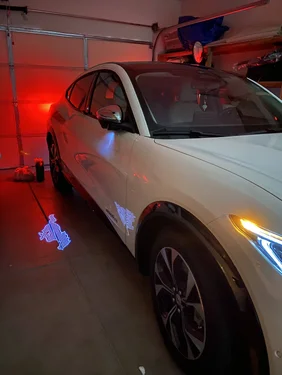

I'm having the same experience as most of you. It just haphazardly works when it chooses to. I do carry my linked phone at the same time as my fob. The fob is in my pocket and the phone is in a case on my belt.
Me too. I’ve been having the same issue. Every time I think I have it solved the pony doesn’t return. SO FRUSTRATING when the great features don’t work consistently, or just decide to stop working. I’ve tried everything. Just now I peeked out into my garage, with neither fob nor phone anywhere hear, and the lights and puddle light turned on. Like sheer motion triggered them. Other times I go out there with just the fob, and NOTHING. They appear at the oddest times, but never when they are supposed to. And the dealer doesn’t have a CLUE. This is so maddening. I’ve already deleted and reloaded PAAK, and re-entered all my settings, three times. Nothing. I agree with other who have said the puddle lights should go on EVERY TIME you approach, and leave, your car with fob in hand. This can’t be that difficult to program. Also annoying is that the auto lock on walk away doesn’t work consistently. Something is definitely wrong with the programming. It is ruining the enjoyment of my brand new car.

Its like the little man in the fridge that turns the light on and off you never see! Seriously, took us a while to figure out what made the pony come out and not. Whenever the mirrors swing back out pony shows up, other times if we've already had been 'welcomed' it won't come on again until it's sat a bit.

Thank you! But it’s also supposed to come on when you walk toward the LOCKED car with the fob in your hand/purse/pocket. Passively, and only with the mirrors closed. And I agree, sometimes it needs to ‘sit a bit’ to perform after it has made an appearance. But it’s sporadic, and rare. Also, how come every time you walk around your car (with no fob or PAAK in the vicinity) you hear the electronics start activating. Why?

You have to have mirrors in and the car locked. Walk out to the garage with your key in hand and when the car wakes up, your puddle lights will be on. However, if you're standing in the house near the garage with your key fob, then car is already awake and the timer has ran out before you made it to your car to check. Same goes if you store your fobs near enough to the car to get a connection. They only stay on a short amount of time.
If you're not getting them at all then you may not have that option.

That is exactly what it was! Either my purse or my key was too close to the garage door. Once I realized that it started working perfectly! So thank you! Also you have to follow the exact same procedure every time you walk away from your car. If you open the door again or unlock the trunk it stops the puddle lights from working.

I see mine pretty frequently in the garage....
I have the auto lock/unlock on and the mirror fold in on lock.
I don't have them auto Unlock, but I do have them walk-away lock
You need to turn on Welcome lights and auto-fold mirrors for them to work
