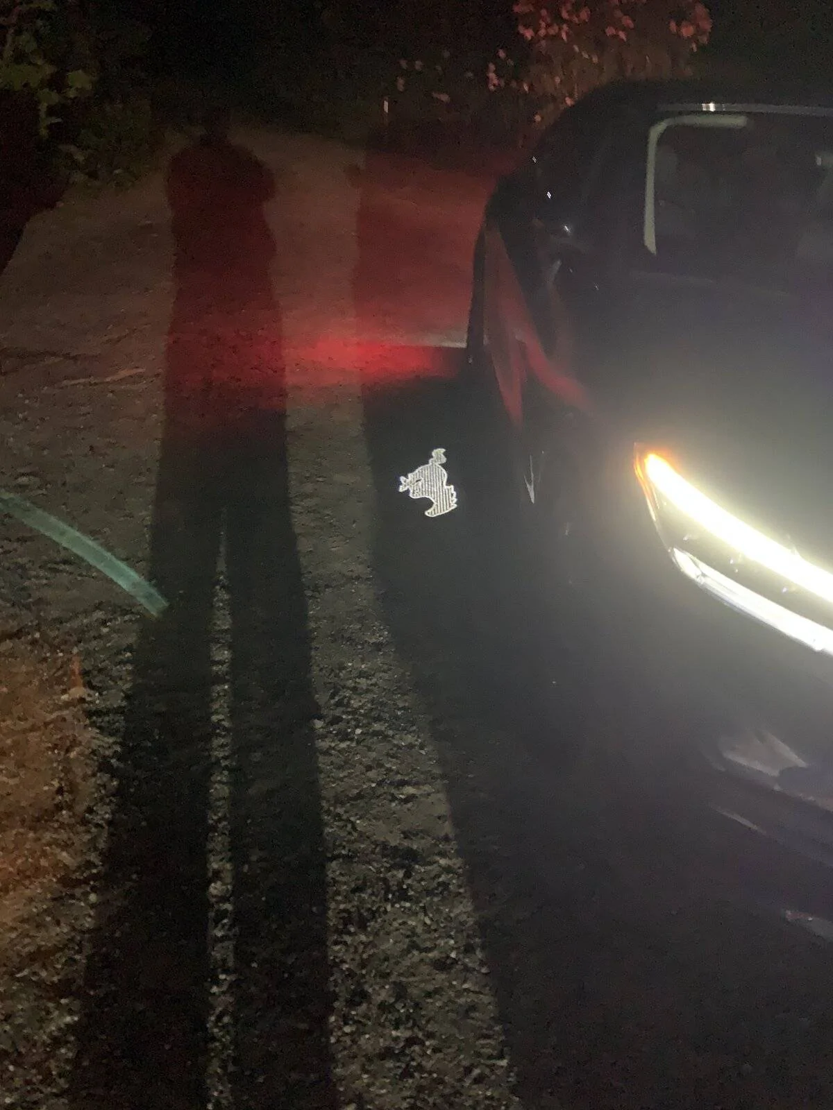

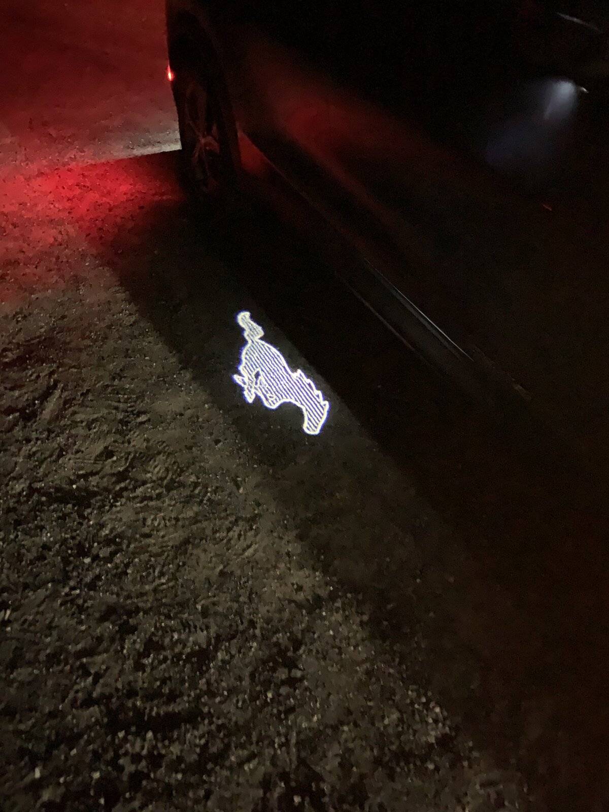

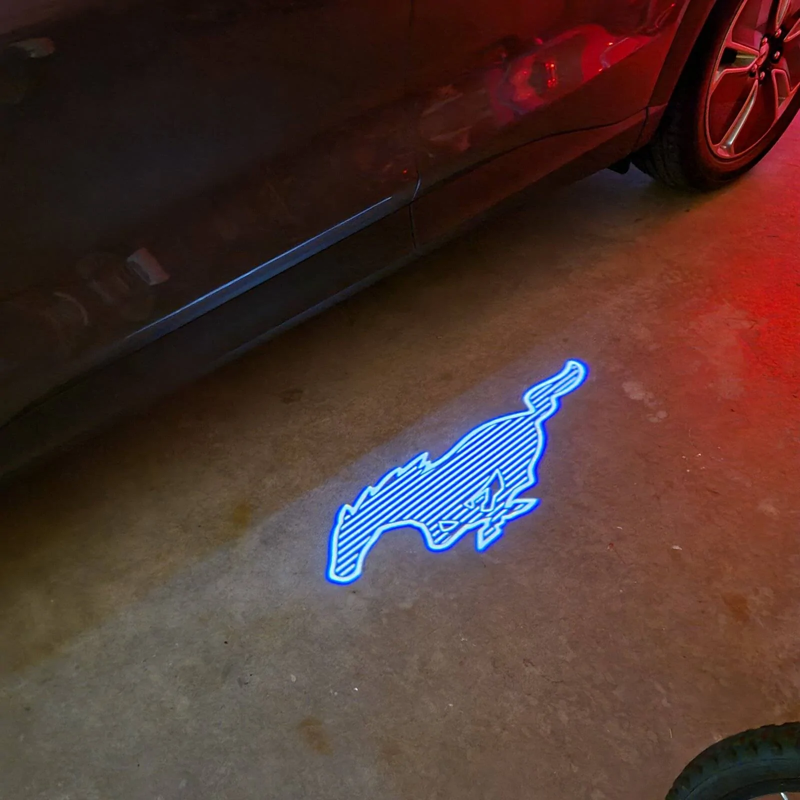

The Select with the tech package (power mirrors) has the puddle lights, I thought I did not but was pleasantly surprised tonight, yeah!!!! So my one and only slight disappointment are the front animated turn signals that the Premium folks got. Those are cool. The Select does not get those....

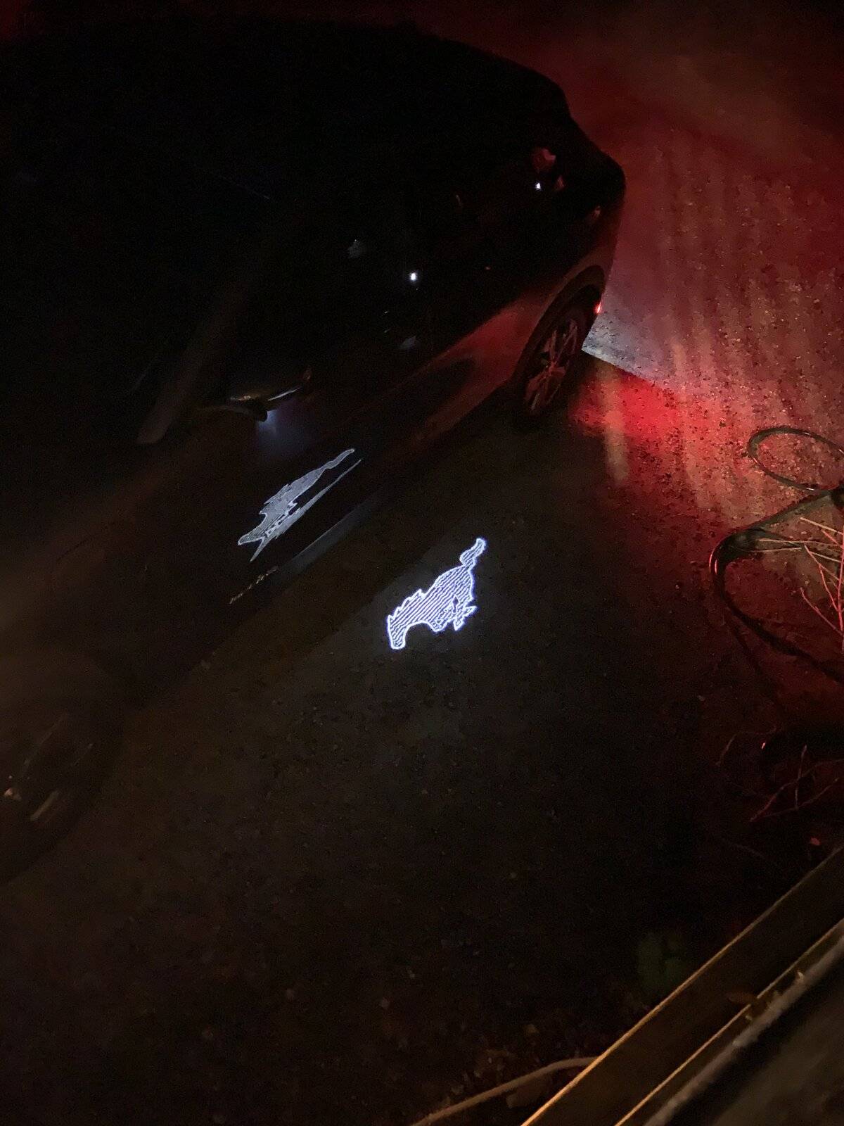

Works ok here, and is very fun to see (PAAK also)
