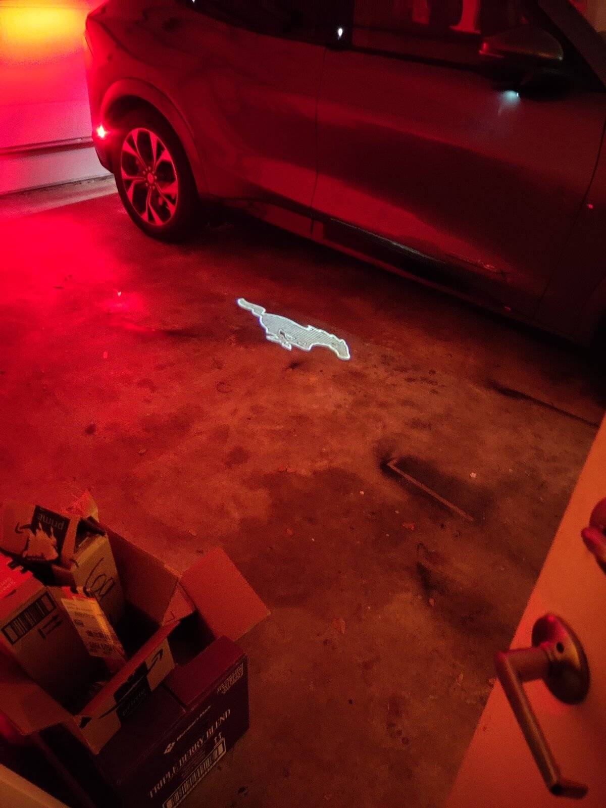

Pony posed for pic! Been seeing the puddle light more consistently!

Before i configured PaaK, the car would consistently turn on the greet lights, puddle lamps and door rings (push buttons) when i was only using the fob. After PaaK enabled on two phones, the car rarely greets me, even with using the fob. PaaK has refused to unlock multiple times and refused to walk away lock at least once. I am hoping an OTA will resolve this. I’m honestly ready to turn off PaaK and get a second fob instead. We keep our phones so close to the car that one of them always shows connected, even if the Ford App is not running. Really want a consistent experience, especially the lock part.
Update:
Maybe I'm being too harsh on PaaK. I have some limited evidence that the greet/pony experience is dependent upon how you approach the car.
It occurred to me after posting this that I had changed my behavior with the car. Lately I've been backing the car into the garage whereas for the first week I pulled into the garage head on. When the car is backed in, I approach the car from the right rear quarter panel and am further than 19' from the front left quarter panel. I generally walk behind the car and along the driver side to open it. Result: No greet/no ponies/no rings lit on the door, PaaK unreliable, Fob reliable for unlocking but without a greet experience.
So I did an experiment. I disabled Bluetooth on all devices, pulled the car head on into the garage and used only the fob. I approached the car, shut the door, turned it on, waited, turned it off, opened the driver door and exited. Result: The car greets me every time I return and the ponies light up on the floor and the door rings light. The car also locks when I go out of range. I repeated this sequence many times.
I then enabled Bluetooth on one of my phones, opened up Ford Pass and left it in the foreground (seems to be a requirement that the app is running in the foreground on my iPhone for reliability). Using the same sequence as above, the car greets me, the rings and ponies light up every time using PaaK with the fob out of range.
Feeling empowered with my abilities. I then tried alternating start/stop cycles using the fob for both and then PaaK for both. Result: Everything worked as advertised.
So maybe it comes down to which sensors trigger first and not confusing the car with too many active keys. I've found that PaaK has longer range before it disconnects so I have to kill the app on the phone for it to disconnect. When I'm at home and the phone is sitting on the kitchen counter it's close enough for the car to detect it, but not trigger greet experience. Not exactly the seamless experience I was hoping for. Thus, I'm still leaning to just get a second Fob and truly use PaaK as a backup mechanism.
