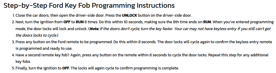

Just ordered mine.I can confirm this procedure works and I now have my 3rd FOB with a working Frunk button!
https://www.ebay.com/itm/354543983990
