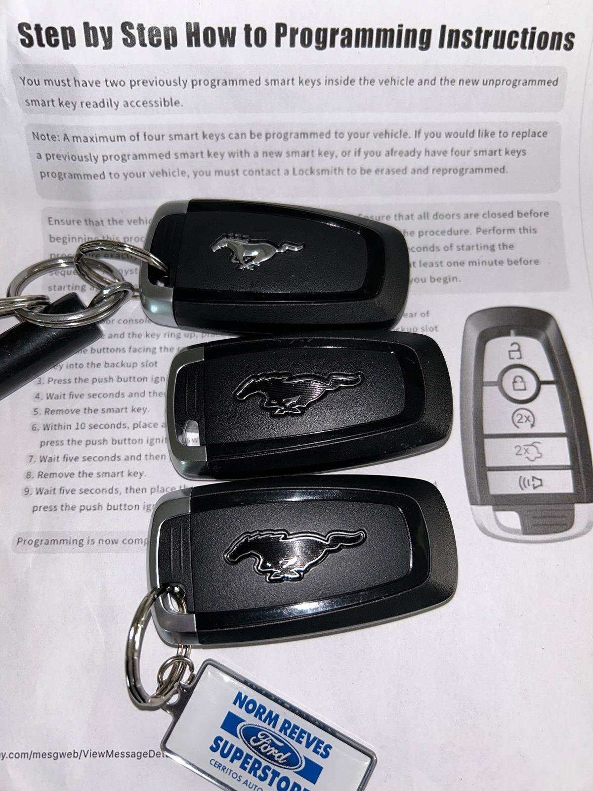

I just bought a Lightning remote and was able to program it with reading this whole thing:
Ford Mustang Mach-E Purchasing and Programming another FOB KeyFob-Programming
I had to do the sequence multiple times with all three fobs. Once I got the key fob successful message on the dash the external lights flashed. Then I was able to program my profile and verify that the frunk worked. Also, I don't have PAAK setup.

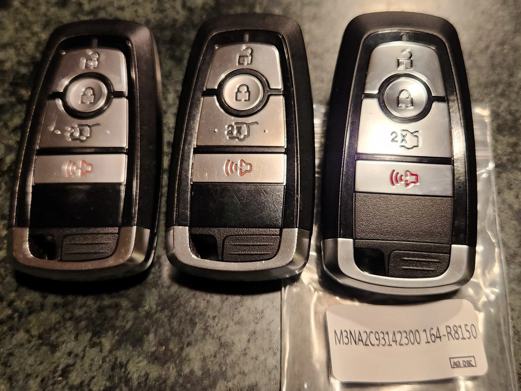

I've pretty much given up on PAAK with my S22+ phone. Too many random "no key detected" messages. So for a backup FOB I got this $39.95 one on Amazon (on the right). It works great on my 2021. Same construction as the OEM FOBs but It has a blank back, so no mustang logo. Programmed it as a 3rd FOB with the above procedure. Note as others suggested I did a fast 5-count not a slow one-one thousand count. Programmed successfully on the first try.
https://www.amazon.com/dp/B0BT215FFP
Edit: This FOB is 315MHz for the '21 & '22 Mach-E. The 2023 (and later?) have a different FCC number and is 434MHz.
