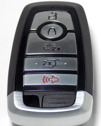

Yeah, I don’t think that applies to the MME. I did find instruction for pairing an aftermarket Ford fob that is more likely to work, and does use the MyKey spot, but it requires 2 fobs which we clearly won’t have.
I can confirm this procedure works and I now have my 3rd FOB with a working Frunk button!
https://www.ebay.com/itm/354543983990
Ford Mustang Mach-E Purchasing and Programming another FOB 1683684308054
This took a LOT of repeated attempts. I was sure I was counting out the 5 second intervals carefully but wasn't able to get this procedure to work. I found two other (completely different) procedures which also did not work.
BUT THEN ... after trying this enough times, it FINALLY worked. Not sure why it didn't work those previous many attempts but at least it works now and I have a third fob.
