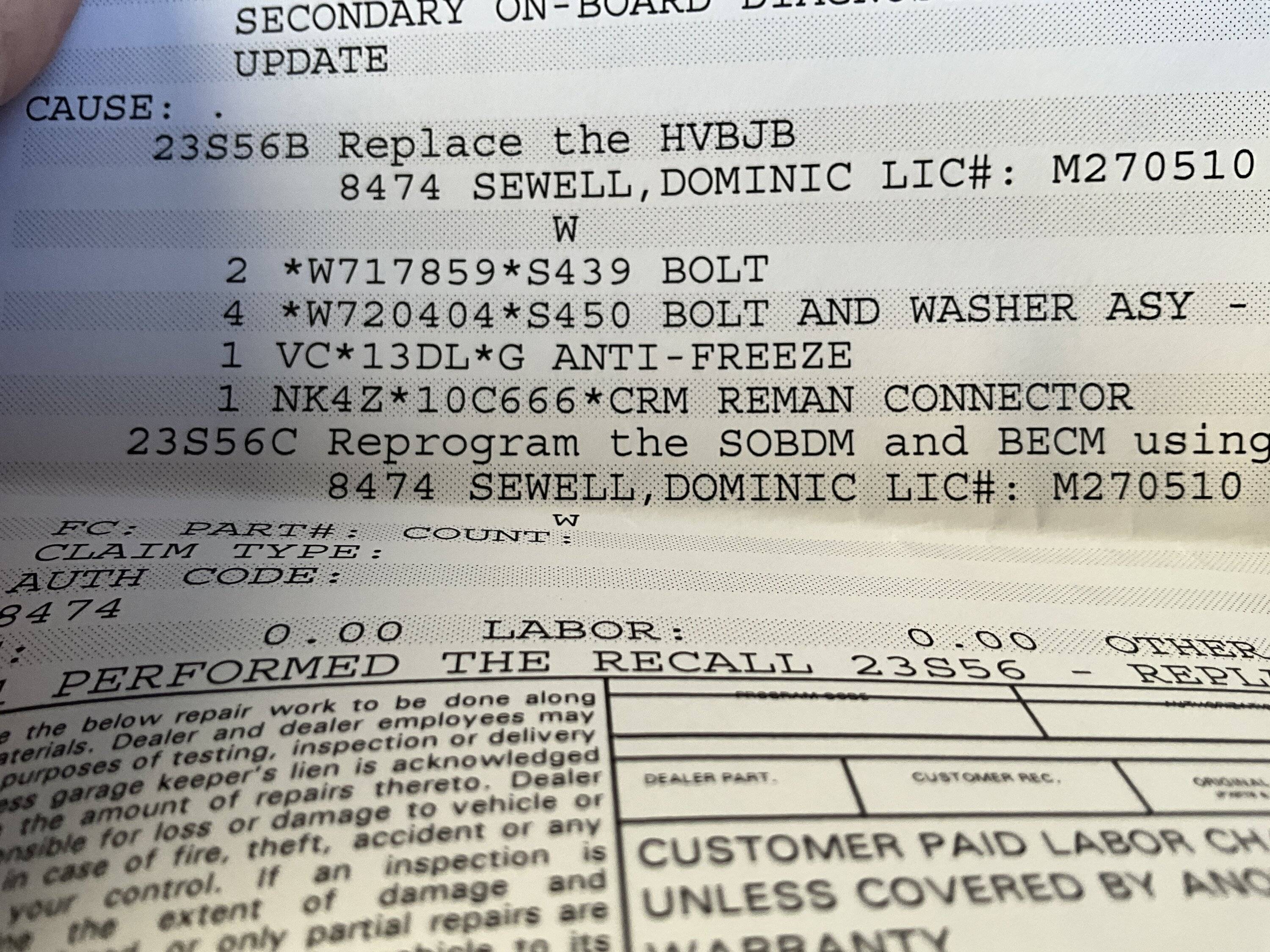

The part number put into my MMe:
“NKZ-10C66-CRM REMAN CONNECTOR”
Take your time y’all Wait for the good stuff.
I think as time progresses all the removed HVBJB will be remanufactored so getting a reman box will increase.

got a call from my dealer yesterday afternoon that the part was in And if could get there that afternoon they had a loaner for me.
dropped it off at 3:30.
i was called today at 3:30 that the car was ready
new HVBJB part # NK4Z*10C666*E is installed

I had my 22 GT in on Friday and received a loaner. Now on Tuesday it was ready. So it took about two business days. Received part # LK9Z-10C666-C

Got my car back today. Took them 4 days to do the recall. Got the "E" part according to the paperwork.
Still having charging issues (where it would stop charging after 3 minutes on a 10kwh 40 amp or greater charger. Have to cycle a few times for it to continue to charge, and it slows from 11kwh down to 8 or 9 kwh after 15 minutes).
