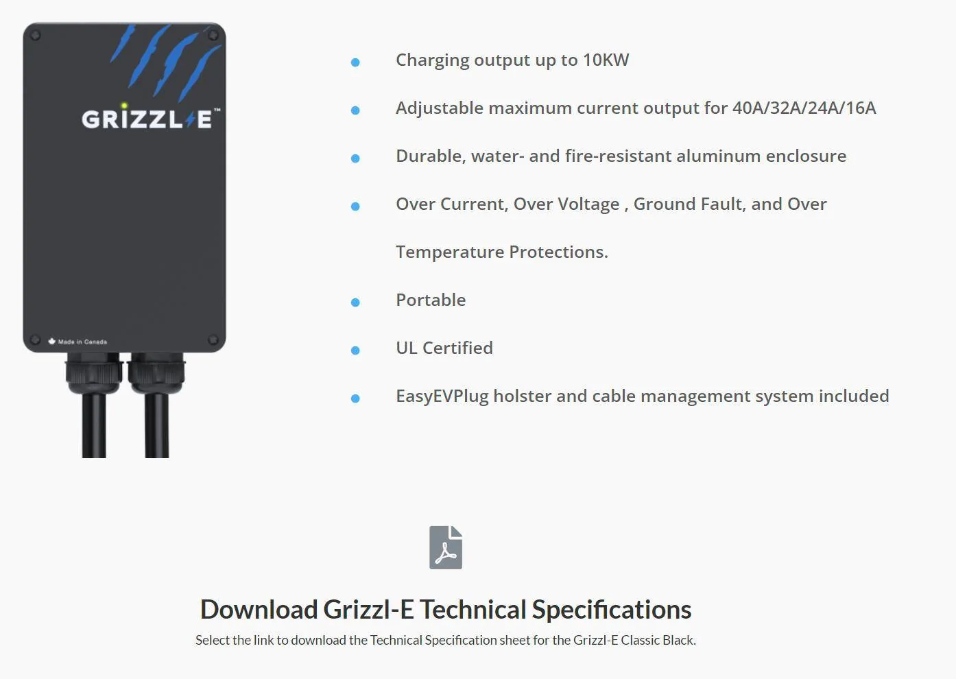

Entirely not true that they are not UL listed. Selling non-UL listed appliances is a serious crime, as would stating UL listing when it is not.
Are you 100% sure that it is illegal to sell appliances that are UL listed?

There is no legal requirement for UL listing.
I stand corrected.
However, it is a requirement for selling at so many retailers as to be a de-facto requrirement. Like Amazon.
The Grizzl-E *IS* UL listed. Whoever said it wasn't should explain themselves, unless they work for another box manufacturer.

You guys are right, Grizzl-E is UL certified. This was my mistake, and it wasn’t driven by any ulterior motives, I don’t work for any companies in the automotive or EV space. I have corrected my original post.
That said, UL certification is kind of a mess right now for EVSEs. There’s all sorts of non-certified junk being sold on Amazon, along with a few other companies that have claimed UL certification because the EVSEs are built with UL-certified parts, even though the completed unit itself hasn’t been tested and certified. Enforcement appears to be lax at the moment.
