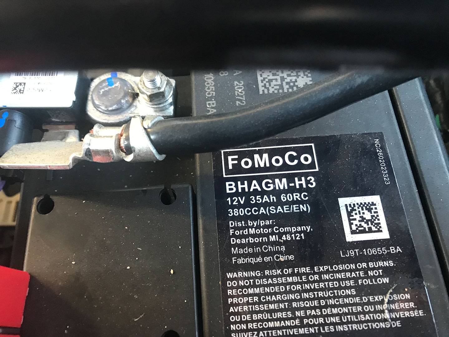

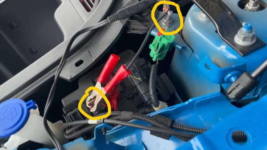

Here's the connection spots if you ever did need to try and trickle charge the 12V battery yourself...

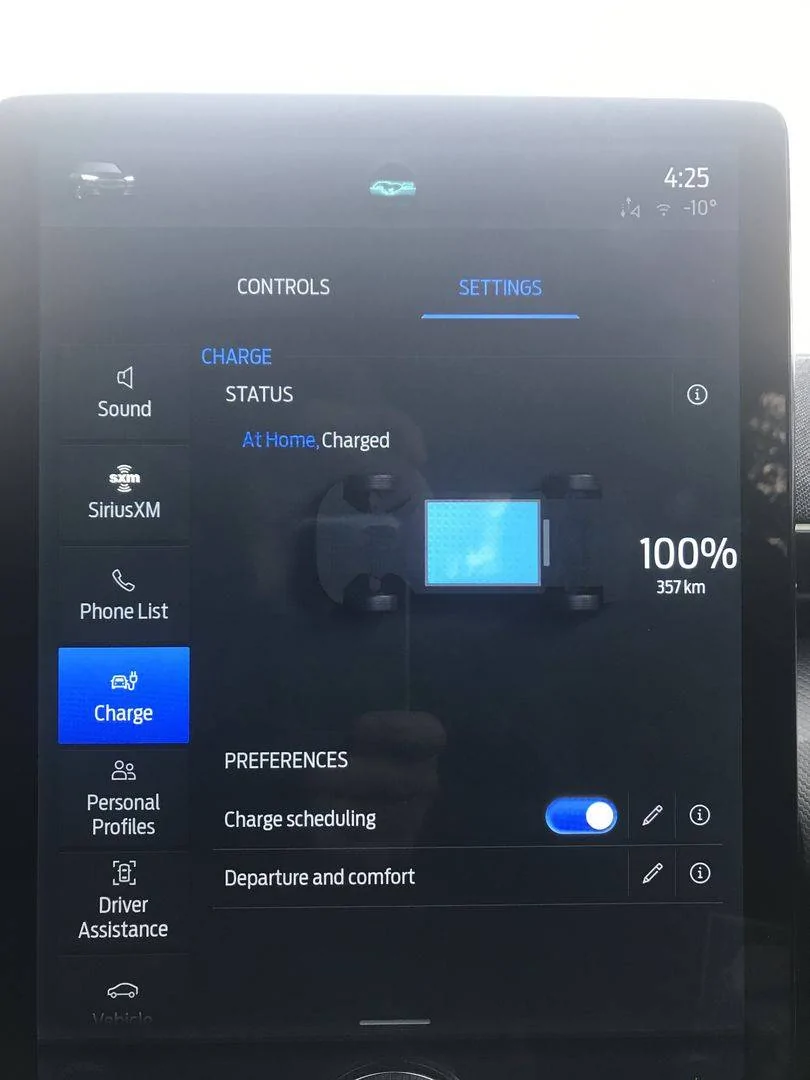

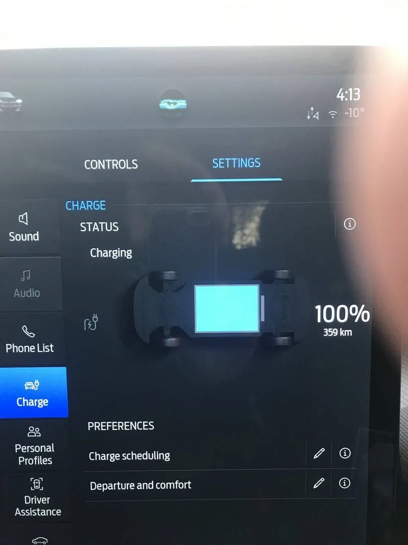

I stand corrected. It depends on if plugged in or not.
Plugged in

Not Plugged in

Yeah, I wouldn't do it unless you're really just stuck. (Or adventurous.) Especially under warranty. Clearly something is wrong that needs service anyway.
Like to think I am still adventurous and fortunately less rushed and with same patience's. Guess they pop out with a standard? I definitely have a agm battery charger for the dump trailer and now you told me I guess I can't let them drive a flatbed out here for nothing. Pretty simple to charge a 12 v you would think? maybe not ;)

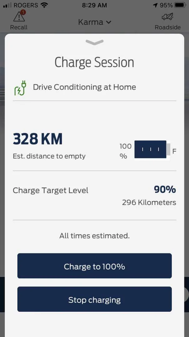

All well this morning the lights came on at around 6 AM maybe something from the clouds (not an update)? We got to see the puddle light :D. Remote started, opened with phone and started up no problems this morning. All running perfect and normal. I have this now which looks promising as it always said 100% before. Need to deplete below 90 to see if working but it will come. Do not delete from saved locations!

These screens all point to low LVB voltage.
Not much we could have done to help. If I could of got it to only charge to 80% I would have had a bit more wiggle room being able to charge it. Eventually I would not have driven it enough and would have it up to 100% in bits. Snow squalls here today. Sky is not falling and not close to giving up on this vehicle yet (you have driven it). Power drains happen and can be fixed. It has gas? It has Spark? It should go? ?

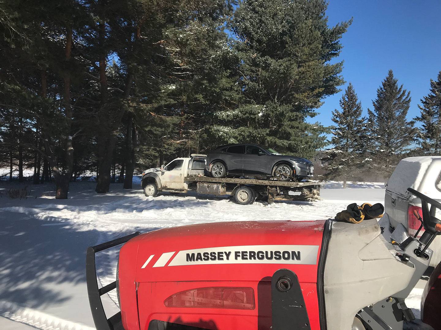

Vehicle will not go into gear with melt down messages posted above continues. Yesterday the tech from my dealer came out and popped the panels on the frunck to access the 12V. He put his jump box on it and got the same numerous messages and no go. Left it and sent a flat bed this morning with the dealers tech shortly behind. He had the paper for emergency tow mode and since I look it up also I guided him thought the menus of the new OS. The setting vehicle menu would not load (monitor went black once rebooted with power button cycle and volume right arrow not required). Got an electric heater out of the house to try to heat up the monitor/cabin. Finally hooked the flat bed 12v to the vehicle and they told me they got to the screen (it rolled up the bed not dragged). It completely die around 5 PM last night last update on app. This morning 4 red squares on the charger port lights. -19 F here this morning on the outside thermometer.
Dealer has been great out same day as reported and flatbed the next ?. Here is my current status
