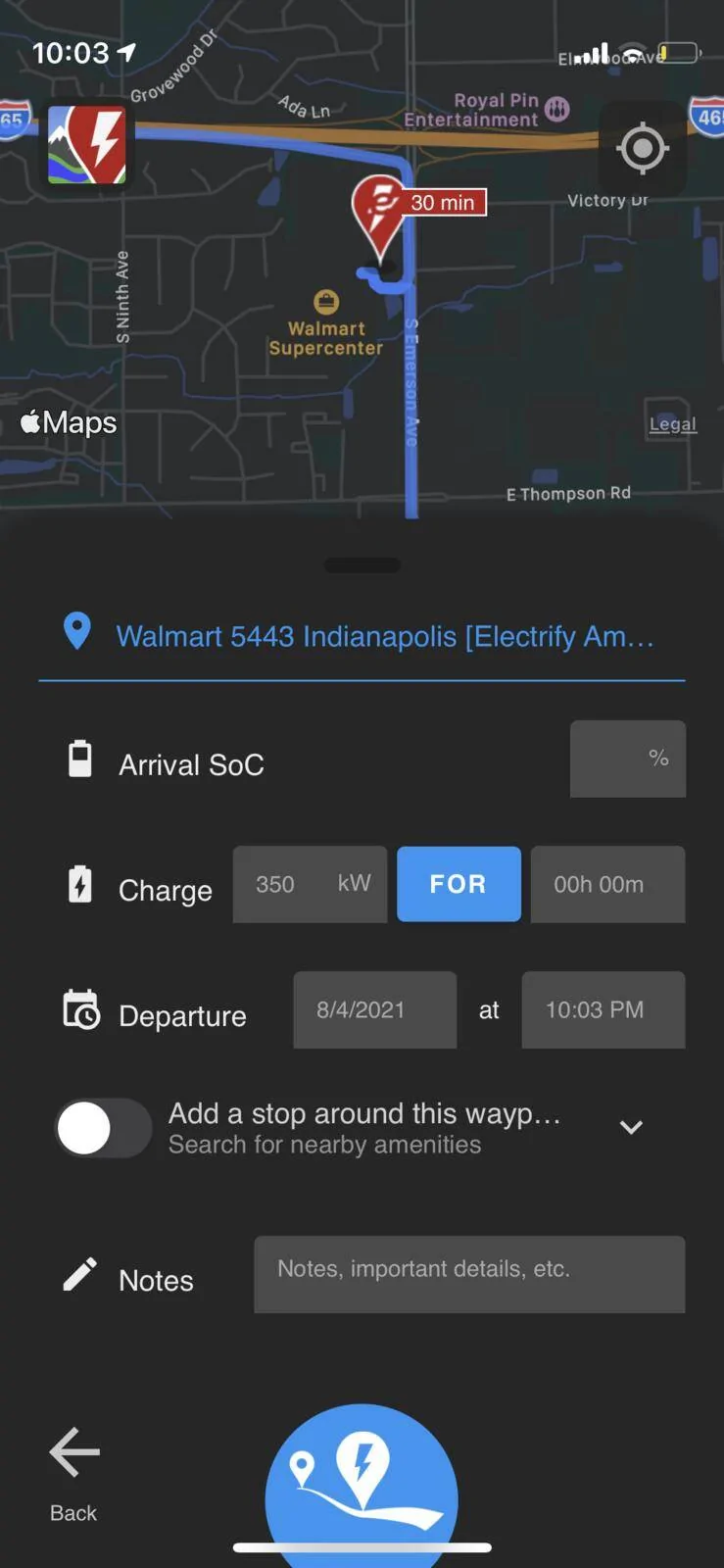

Not as convenient as setting a default, but you can go to each stop in an ABRP route and set it to charge to 80%. Do them in order and one at a time, tapping/clicking the route calculation button after each change. I have used the feature several times.
Unless I’m misunderstanding, I’m not seeing a way to do this. I see an “Arrival SoC” but I think what I would be looking for is “Departure SoC”. Example of what I’m seeing for 1 charging stop:
Click on the word "FOR" and it will switch to the word "TILL" and you enter a percentage:
