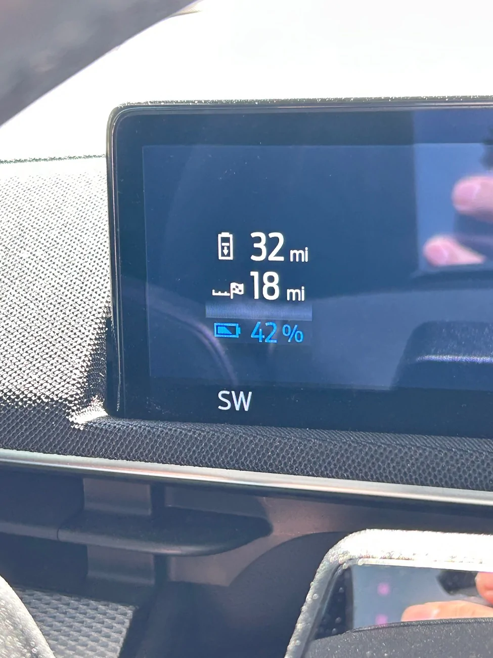

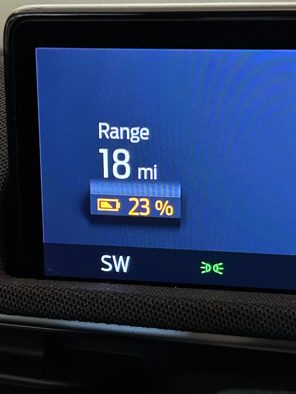

I parked my car this morning after driving to work with 42% battery remaining and well over 100 miles of range. When I started the car after work to drive home the battery was at 44% but stated the range was now 32 miles. Luckily I only had an 18 mile drive home but any idea why this happened? When I got home I was down to 18 miles of range with 23% battery. Do I need to bring it into the dealership? It is a 2023 with LFP battery still under warranty. I took pics of when I left work and right after I got home. Thanks!

You need to charge your car to 100% on a monthly basis. The BMS for the LFP batteries is subject to drift, and charging to 100% periodically re-calibrates things. If it is still showing odd range figures after that, then you should take it to the dealer to have the battery looked at.
11,354
24,981
You need to charge it to 100% ASAP. If you do not regularly charge a LFP battery to 100% (at least once or twice a month) the battery management system (BMS) can accumulate a lot of error which can cause sudden state of charge drops as you experienced.
You do not need to bring it to a dealer, just do the 100% charge every two weeks.

Thanks for the advice. I rarely charge to 100% but I’ll be more diligent going forward. I’ve had the car almost 2 years now and this never happened before so I was super worried :LOL:

There's a good chance that's the issue especially considering the OP's reply, but the SOC didn't drop, only the GOM did. Could be typical GOM nonsense.

a 19% battery usage for 18 miles is pretty bad unless the weather is very very cold
