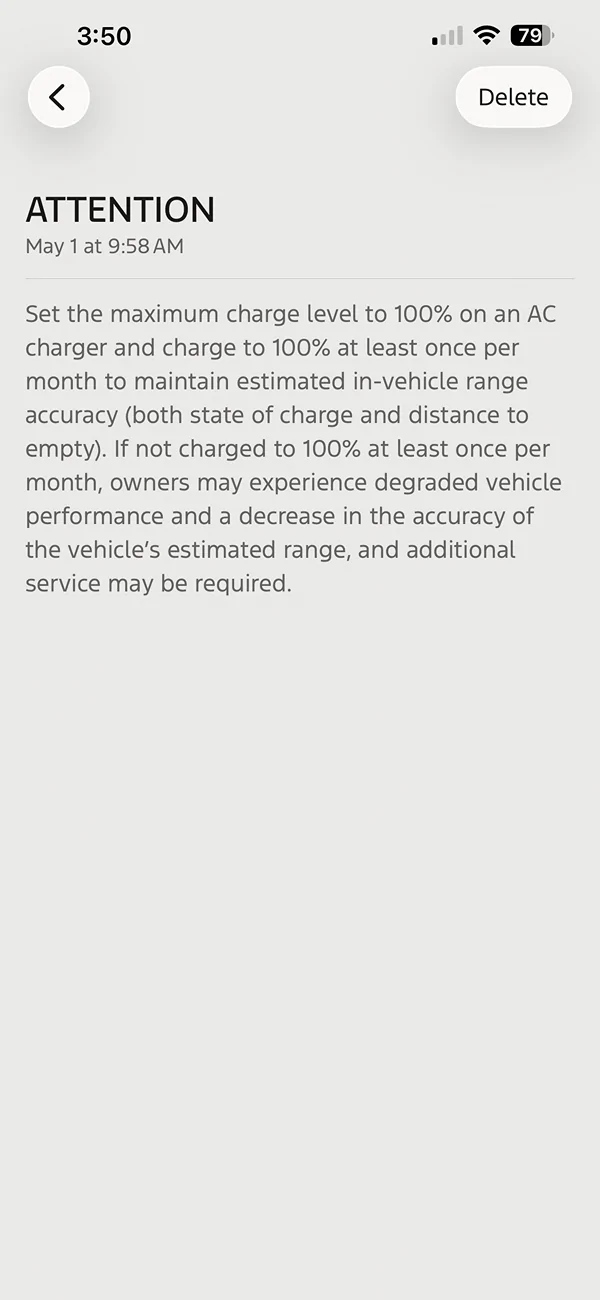

Yes! Charged to 100% and I’m showing over 200 miles of range. Just realized I got an email from Ford on May 1 telling me to charge to 100% but I didn’t listen. I’m fairly confident they screwed up my range on purpose for not listening LOL.
