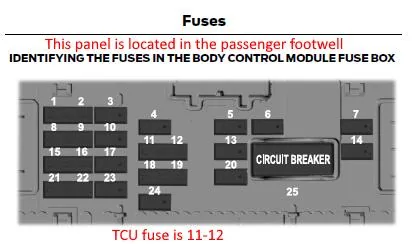

Ford Mustang Mach-E SIM removal - how to? MME_TCU_Fus

Technically, it’s just location 11. I have a 5A micro-3 fuse with one side blown that I took out of that location because the half of the fuse that serviced location 12 was blown. The left side door buttons And the B-pillar keypad weren’t working. Anyone want it? ??
