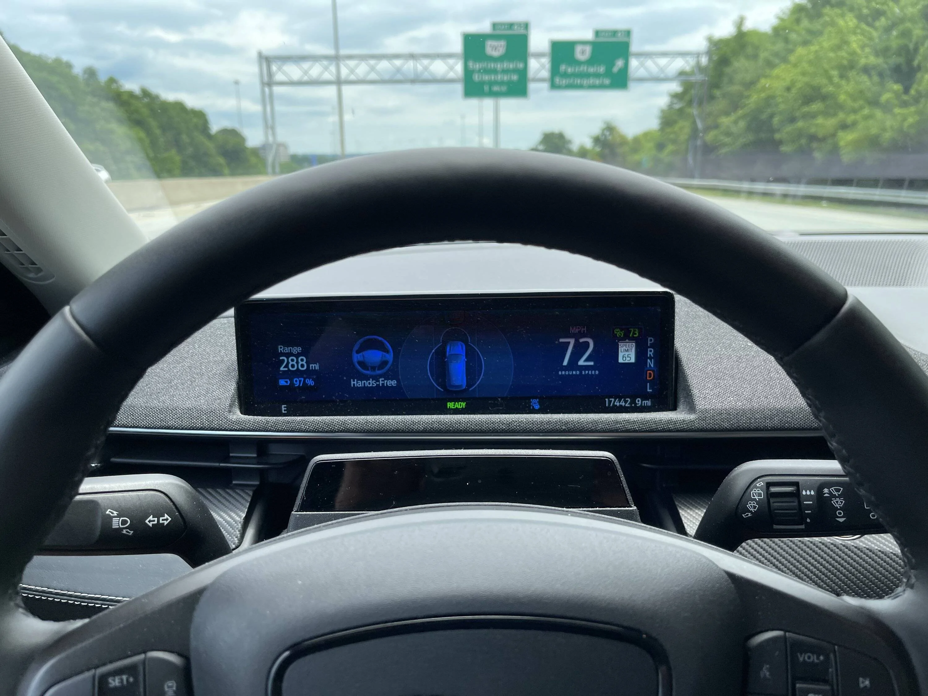

*UPDATE*
Overnight something reset and now blue cruise handsfree is working
chris e
Aug 4, 2021
cincinnati
Mustang Mach-e
Quick follow up: bluecruise finally started Working a few days ago and it’s great. It’s too bad Ford’s marketing and communication caused so much frustration .
