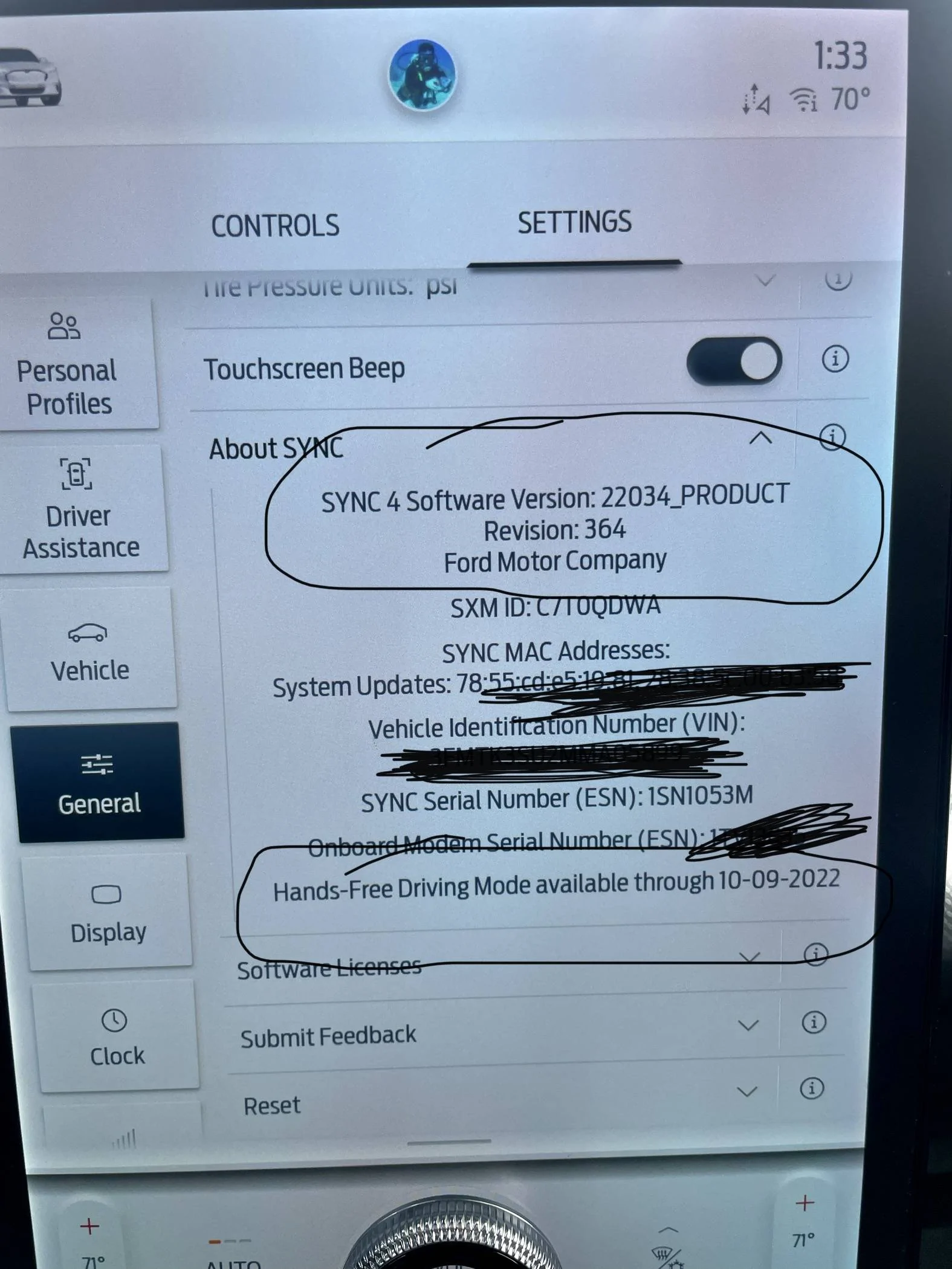

What’s sync 364?
Two things you should see:
Sync Revision 364
Hands-Free Driving through October 2022 (that's when the maps expire, not the free period)
