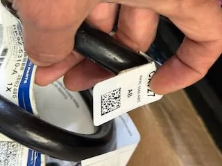

good news and bad news.
bad news first:
i was sent 2 sets of rear springs. tasca had both 1) a larger blue ford heading label 5310-A (front spring) and 2) small tag with qr code and 5560-ABC (rear spring) attached to the springs.
i honestly didn't even notice the smaller tags since on cursory check of the larger blue ford labels, it looked like i was shipped two 5310-A and two 5560-ABC springs. what a pain and waste of time to have to deal with a return and potentially another trip back to the shop.
good news:
despite not having the correct fronts, the shop did install the rear springs and boy has the ride quality improved significantly! to use an overused phrase, it should have come from the factory this way!
i've always thought the mach-e had a stiff-legged ride. magneride improved/resolved the rear "bouncy" nature that existed to small degree on my premium RWD, but it still rode very stiff legged especially over small-medium bumps, especially noticeable at slow-medium speeds. in fact, i always felt magneride was best at faster speeds when the amount of travel was less critical.
not sure if ford did this purposefully for aero/battery-saving reasons... or just mis-judged how much the weight of the battery/car would use up minimal spring heights. either way, the car actually rides like a car now, rather than a truck.
driving back from shop on the pot-holed streets of LA, it's remarkable how 1" of additional rear travel alone really lets the shocks do their thing to absorb the small to mid size bumps. the eibach sway bars still keeps cornering flat.
debating even bothering with the fronts. you can tell the rear tire gap is slightly greater than the front if you look carefully. but since there's already a decent gap in the front it's not as noticeable as with a partially lowered car.
for now i'm waiting to hear back from tasca about about getting these extra rear springs returned and refunded.
if i do decide to order the front springs again, should i just do what i did last time and put in the part# again and hope they get it right this time?
or is it better to select by model and choose "2025 - ford - mach e- rally" and go into the rally parts catalog and pick out the front springs that way? is that safer?
Ford Mustang Mach-E Softer Suspension? IMG_3504

Wow, that stinks. I ordered my springs from Tasca without issues, and I am surprised of the mix up.
What springs are you running in the front currently?
I think you could provide great feedback running your current setup and then switching to the front rally springs when you get them, if your financial situation allows it. I'm not sure anyone else has such a unique situation as yours where half the springs are installed.

Definitely put in the part number and never enter in your cars info especially the VIN. I order these springs from them all the time and never have had an issue but I know others that have added their car’s info and have had issues.
I would absolutely have the fronts installed. It will ride even better and level out the car more.
