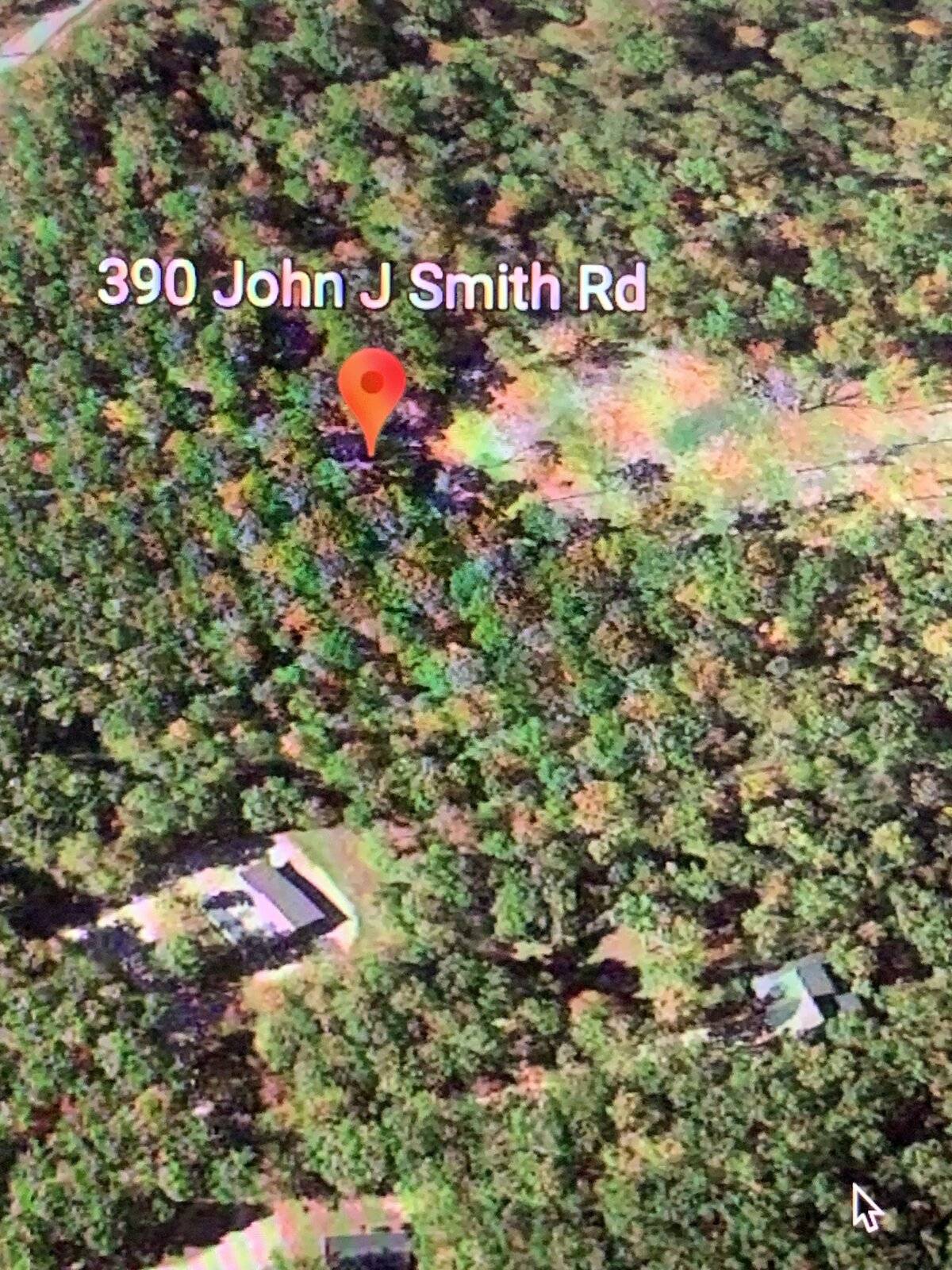

Ground vs roof is the same cost from these folks with the exception of the trenching work. My roof is not even remotely a viable location for solar. Way too many trees, I could give you my address to google earth and you won't be able to see the house. Not even exagerating. Our solution is place a ground array about 200 feet from the house in the horse pasture in direct sunlight.

OK, just to show my unique situation. Here's a goggle earth pic. That red flag is the house. I know, you can't see it. That clearing to the right is the pasture. That's our only option for clear sky.
Maybe I'm chasing my tail thinking we can make this work for us, but I'm trying. LOL

The plus side is you have a great place to live. It sure does look like you need to put them in the horse pasture, huh? If you are game do ask what it would cost if you did the trench yourself maybe. The ditch witch is an easy rental, and the number for your local dig safe is a few clicks away.
