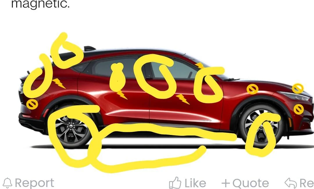

#2 made me curious so I checked where a magnet would stick. We knew the trunk lid was plastic. Validated that the hood and fenders are not magnetic.
Forgot a couple non-magnetic places. I fixed H2b
Ford Mustang Mach-E Some Observations After Delivery Screenshot_20210212-220119
