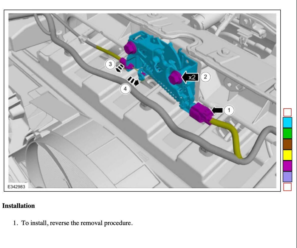

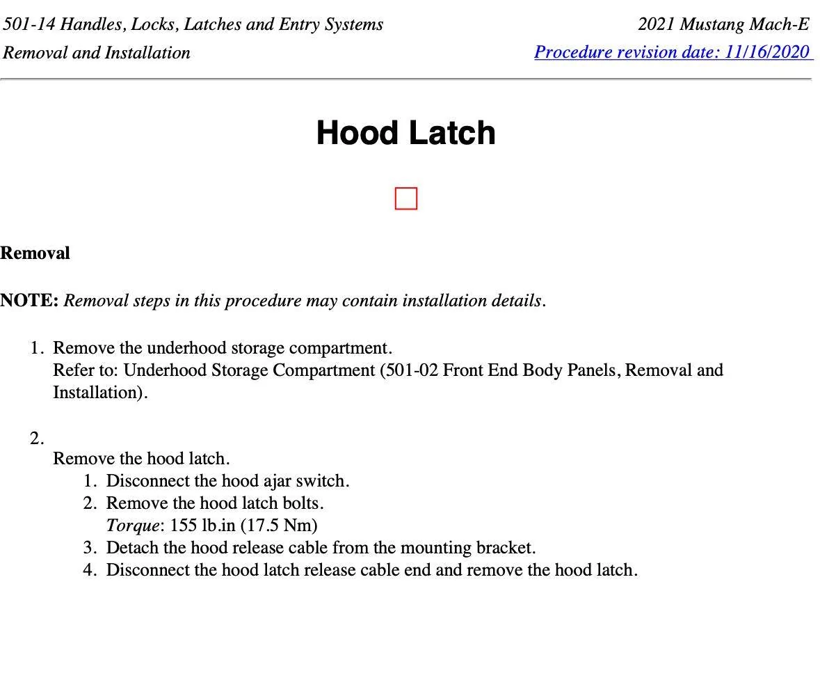

Yeap, but it looked to me like there's one latch assembly that contains both of them. And they told me / Ford CS when they called yesterday afternoon that all of the parts were in.
Here's the repair manual, there's one hood latch assembly / part. So I call mild BS that they're lying and there's some other reason why my car isn't done today. Just gotta hope for the best as I cruise in my dirty white interior Mazda CX5 rental car!

From my experience with this it was just one mechanism they ordered. It double latches, but in one mechanism.
