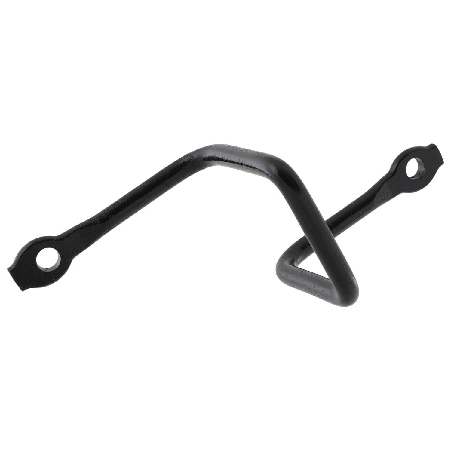

The tech popped the hood, and yep, it was stuck as I described. The tech then proceeded (despite my describing to the service advisor that the frunk eventually closes) to use a hacksaw to cut the striker on the hood to open it. The dealer then ordered a new striker (to replace the one they destroyed), the latch, as well as the frunk actuator mechanism.

It looks like they unbolted the striker from the hood to me, are you sure they cut it? Unbolting it is probably what I would try too.
Service advisor told me they physically cut it and that's why the car was undrivable ??‍♂ I'll probe some more if I don't see parts showing up at the dealer on Monday. @Mach-Lee you have any way of knowing whether that striker is a part that is used on other Ford models (and therefore might be more easily obtained)? I think I can get the thing closed if the striker was back on.
They could just bolt it back on. It looks intact from what I could see in the video. He might be telling tales, or another part of the latch was damaged or had to be cut.
Part number is LJ8Z-16K689-A and it's unique to the Mach-E.
Thanks -- I'm going to get into this with them on Monday. They probably just don't care at all about me, and want my car sitting there for whenever the part shows up and they have the time to put it on.

I watched the video again, when he first opens the hood he's looking for the two bolts he just unscrewed with his ratchet. He's got one sitting to the left of the latch, but the other bolt is missing so he's looking in the frunk and under the car for where it fell. If they lost the second bolt they can't put the hood striker back on and let you drive it until they get a replacement bolt. The may have found it later after they took out the frunk tub through.
