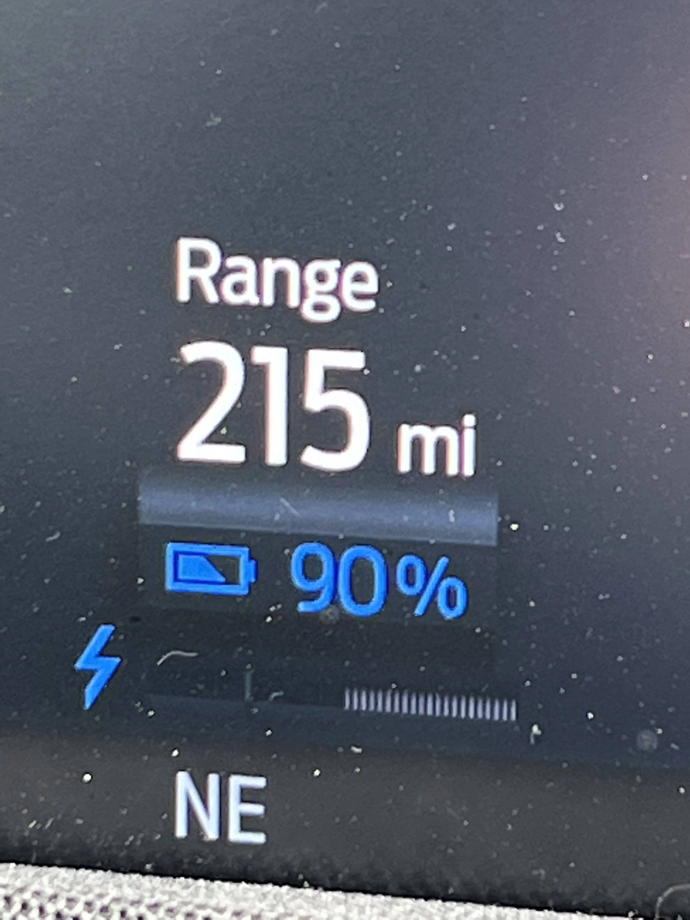

SO MANY GREY BARS!!
This Mustang has been Gelded.
Ford Mustang Mach-E SVS.. My turn 424EF887-5B15-420D-B8B8-4A5EFE8FD98B
I ended up getting off work 2.5 hours late when someone had a medical emergency requiring my services close to the end of my shift. Still had a 4.5 hour drive home. While driving home I called the dealer, Davidson Ford of Watertown NY. My mechanic is off work this week. No big deal, it’s Friday. I asked if there was any way to at least get the parts on order to get the ball rolling for whenever the mechanic does get back? So they told me to swing by with the car when I get back to town.
Also while driving I called the BEV team and got a case number started. When I get a rep I’ll try to get parts expedited.
Home from work. Jumped out of the rental and into my MME. I’ve never seen so many grey bars

Just to keep the thread updated, still no part. My local parts guy says it shows back order with no ETA. The BEV team hasn’t made any attempt to contact me. When I called them, I was told they’ve marked the part to be expedited but won’t know anything until after it’s shipped. (Basically I felt like I was being told “Don’t call us. We’ll call you.).
In the meantime I’m still driving my car around town. Amazing how much your efficiency an go up when the car accelerates like mom’s minivan.
