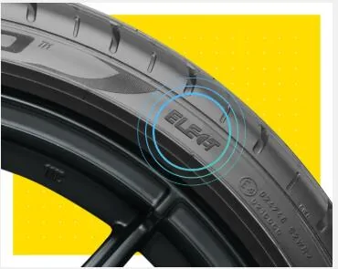

It seems odd that the Pirelli site does not list 245 45 R20 as an available size. Do your tires have the ELECT marking on the sidewall?
I am not running these tires. I don’t run that size.
However want to mention that Pirelli does not always mark the sidewall of their tires ELECT even when they are in that series, especially if they are made OEM for a manufacturer. Many of the Pirelli summer tires on the GTPE did not have ELECT on the sidewall.
Also Pirelli lists more tires on their website that you won’t find in tire stores but you can special order them. You really have to do a lot of research when it comes to tires.

I cannot find my notes right now but the ELECT and non-ELECT are not the same tire with just acoustic foam added. In fact, Pirelli makes many ELECT tires that do not have the acoustic foam. From what I remember, their ELECT tires have a different construction compared to their non-ELECT to give up to 10% more range. Also, the tread compound is changed to give up to 20% improvement in wear compared to the non-ELECT tire. If I find my notes from Pirelli which are more specific, I will post them. Like you said, I would think the ELECT tire would have a loss of grip but then this is a high performance all season so should at least have a decent amount of grip.
