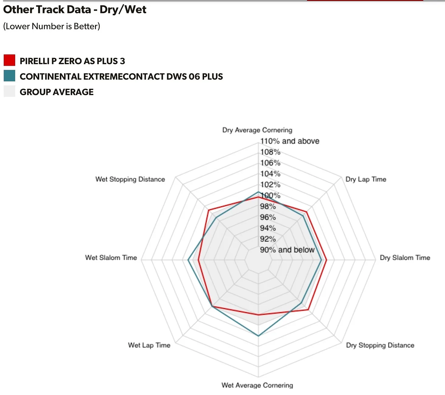

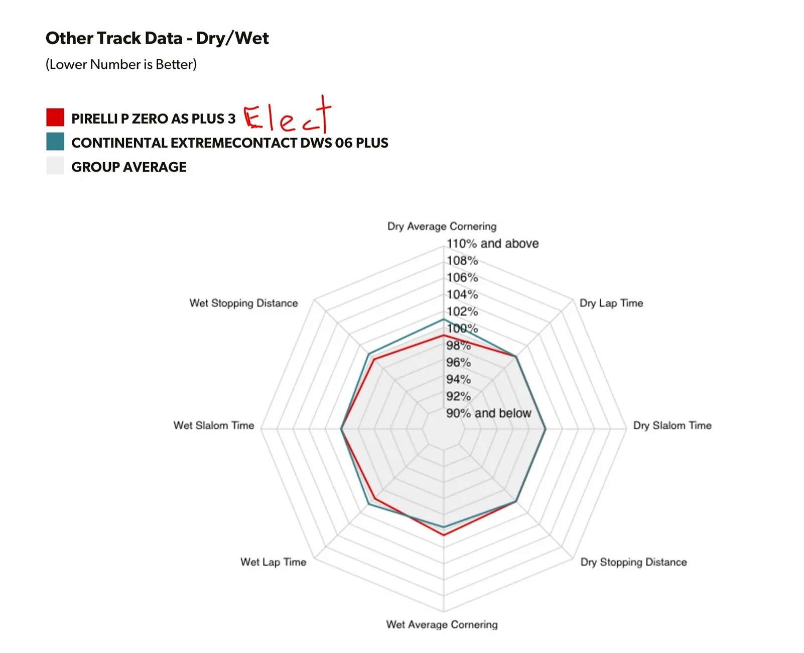

I was finally able to find some data to compare the AS3 regular to the elect. Tire Rack tested both of them, and while they didn’t do them head to head, the DWS 06 was in both tests, so can provide a reference point. It isn’t a perfect comparison, but it’s the best I can do until someone tests them head to head.
It appears there’s a small drop in a few metrics relative to the DWS06, especially wet and dry braking, which are at the top of my list. For me, a bit more braking ability is worth a little more noise. Also, have been seeing a few stories about issues when the foam inside separates, not specifically with the Pirellis, but EV tires in general. So one less potential issue avoided by going with the normal tires.
I have a set of the normal AS3+ that have just dropped under 5/32nds of tread at 23,000 miles. I was going to wait to see what kind of test results the Cross Climate 3 Sport tires got, but it seems like it will be a year or more before that tire makes it here and gets tested, so am putting on another set of the AS3+.

I was/am a little confused re: your statement "It appears there’s a small drop in a few metrics relative to the DWS06, especially wet and dry braking" - The graphs say lower number is better, so doesn't that mean the plot points closer to the middle (lower % numbers) are better? If so, it would seem the AS3 Elect outperforms the DWS06 except wet average cornering. I'm assuming the % is referencing some standard braking distance / cornering time / slalom time.
Am I missing something?

I think they have the chart labeled incorrectly. The gray shading in the middle is the "average" of all the tires in that particular test. The lines represent the relative performance of that particular tire in comparison to the others. So 101% means that tire performed 1% better than average. 99% mean the tire performed 1% worse than the other tires. If you dig into the test report, you can find actual numbers.
For example, the test represented by the first chart has the number for the DWS wet braking at 128.6ft, while the AS+3 elec is 129.4ft. The DWS dry braking is 119.3ft and the AS+3 elec is 119.6ft. That corresponds with what the lines show.
At best this is a rough comparison. You can't really compare the numerical data from the EV test to the UHP test; different test cars, drivers, and track conditions make that useless. But if you decide the DWS performed a little better overall than the AS+3 elects, and the AS+3 non-elects performed a little better overall than the DWS, you can infer the normal AS+3 performs better than the AS+3 elects.
That's the best I'm going to get unless someone does a head to head comparison.
