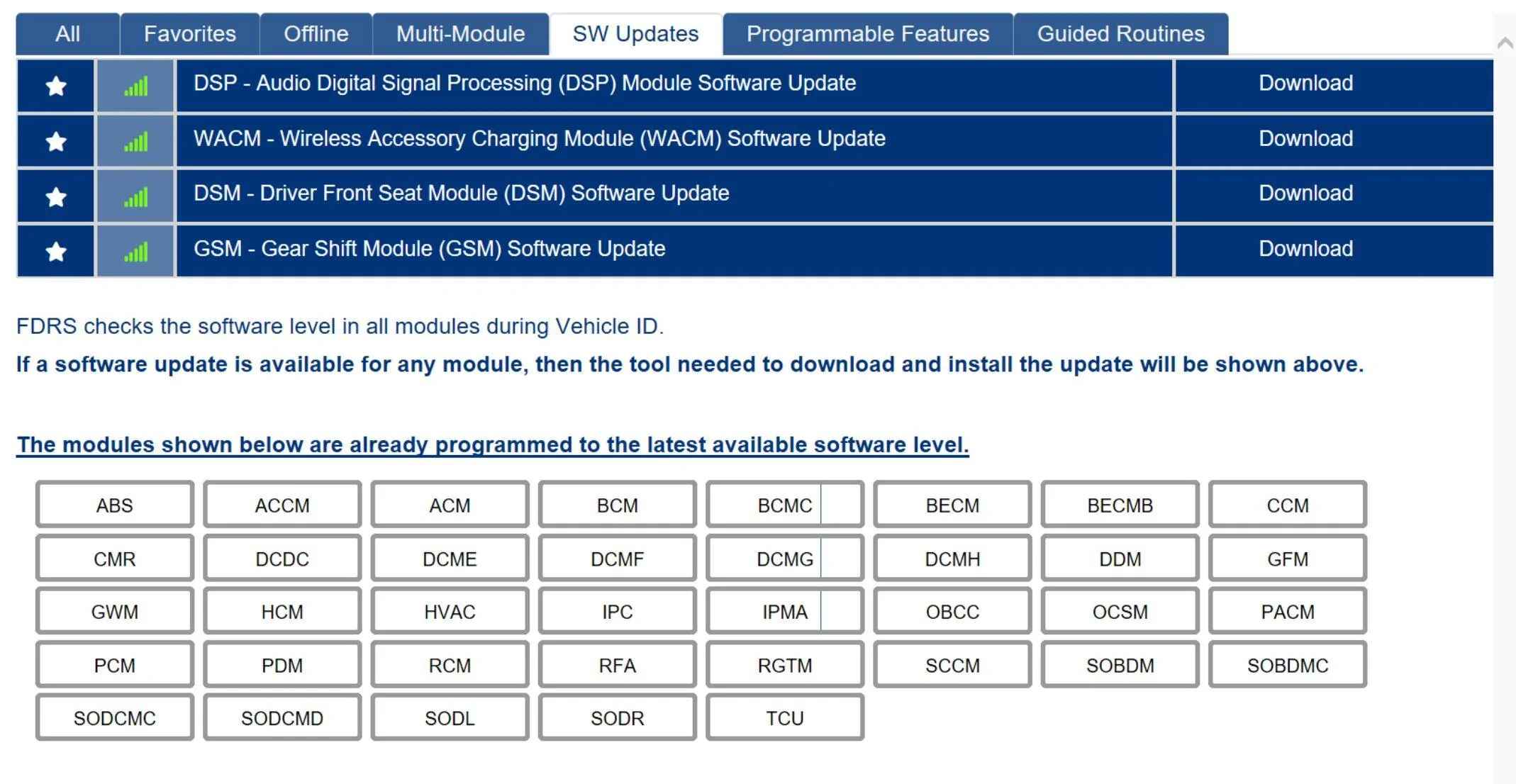

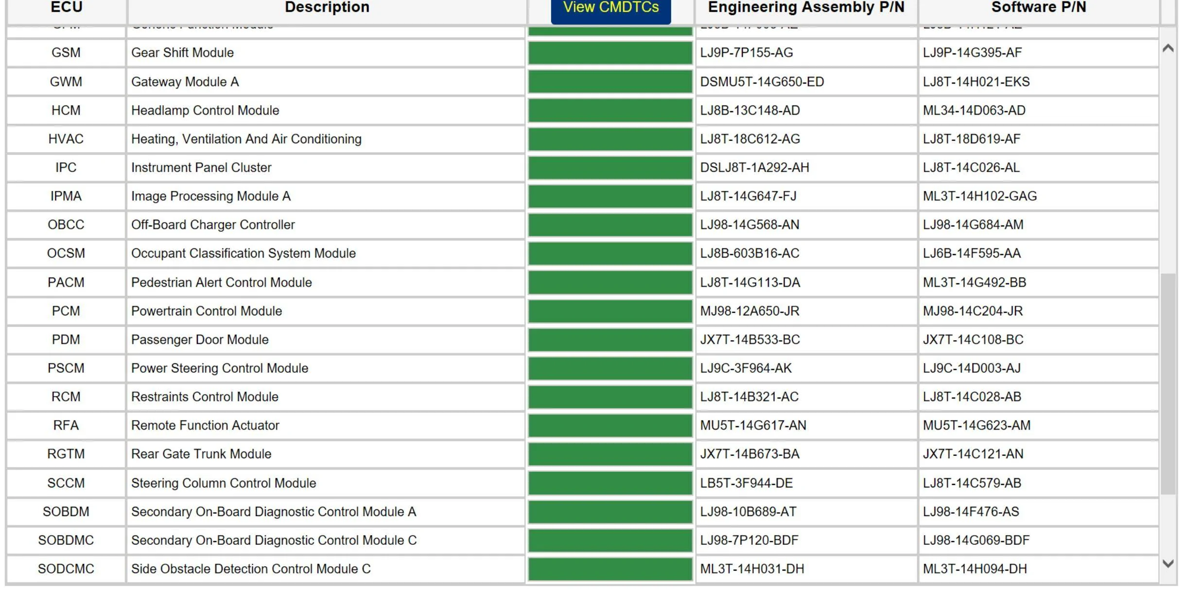

Heres some of the relevant software versions
My GWM version is HKD, so there's definitely a newer version than what you have. Sometimes updates pop up after other updates are applied, so I'd just go ahead and start with the PCM.
Yeah I’m just going to run through these until there’s none left hopefully the relevant ones will appear eventually

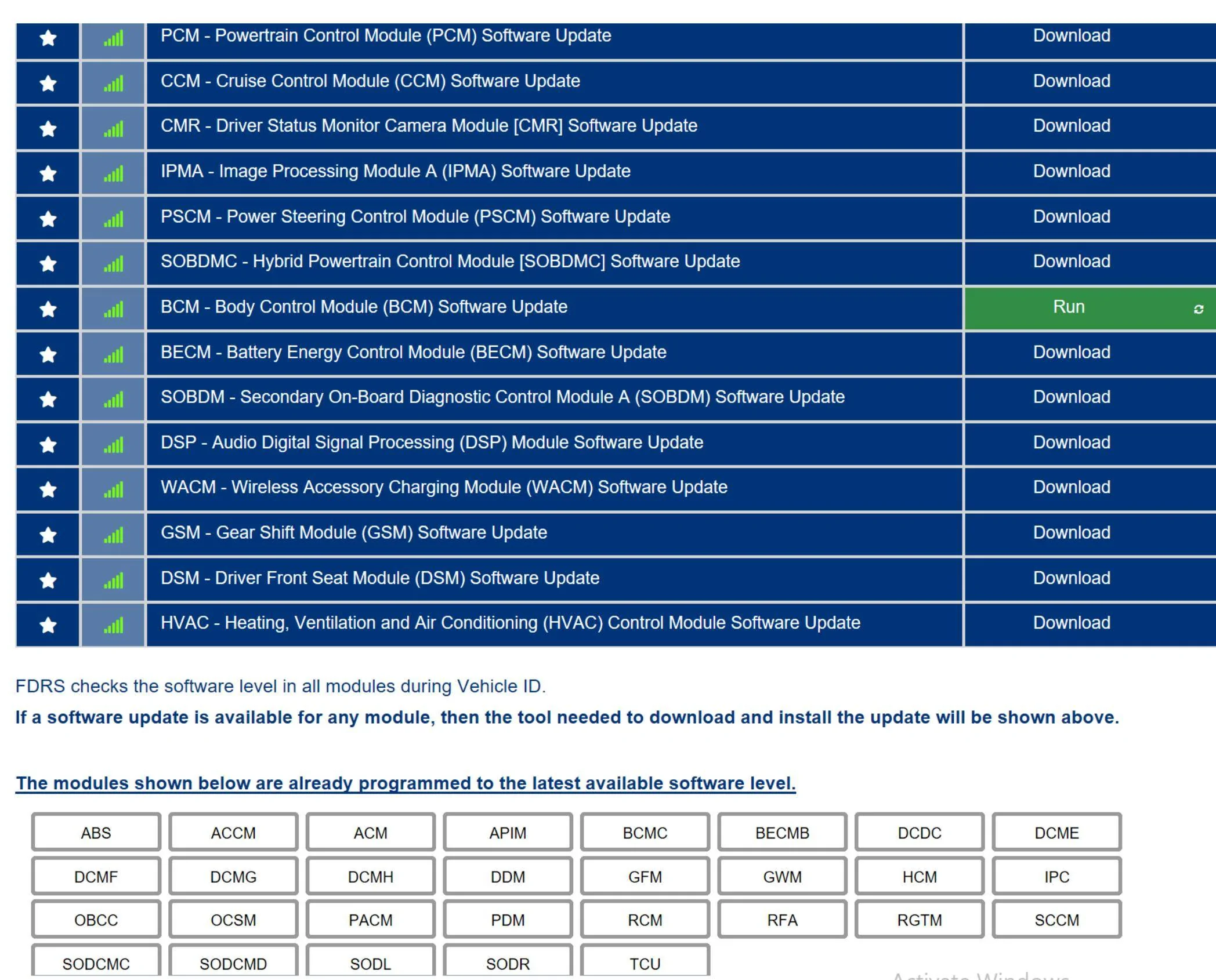

Yeah I'm working my way through nothing new popping up yet. PCM, BCM and requirements all done doing CMR now then onto IPMA. I'll be really disappointed if i spent all this money and don't end up with Bluecruise.

New PCM, SOBDMC, SOBDMB in FDRS. Job1
I just ran these updates. PCM went from AXL to AXM. SOBDMC went from AXJ to KD. SOBDMB went from DF to DG.
The updates ran without any issues, but I've been having a random issue with FDRS lately where it hangs for 5 to 10 minutes after launch. Anyone else experiencing that issue?

I dont think I'm getting Bluecruise on this car still no GWM TCU or APIM

at a bit of a loss at how to proceed here i dont think any of the remaining modules will be any help.
Go ahead and update the rest of them anyway. When it’s done, clear any DTCs and do another network scan.
